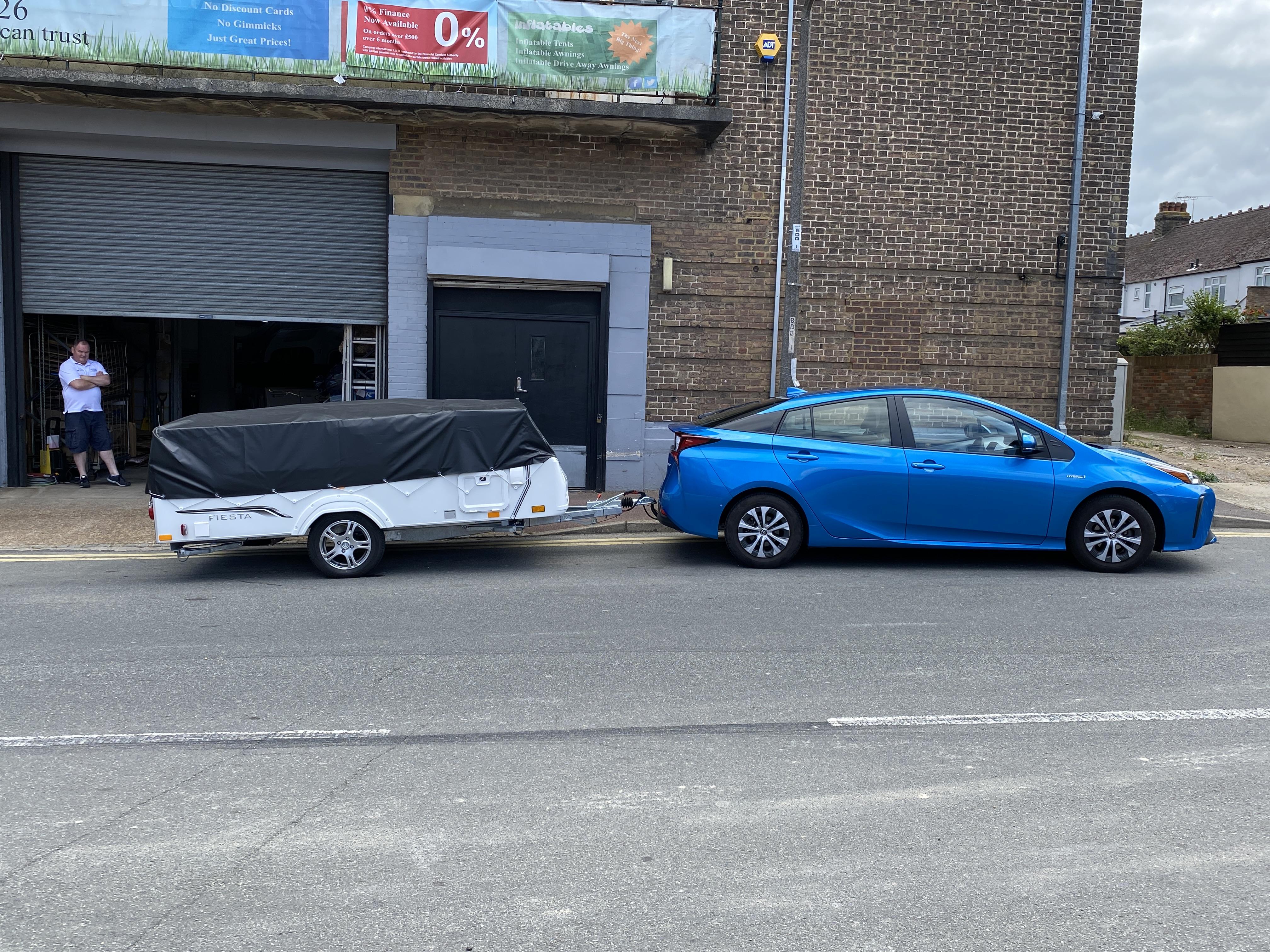

I have been towing 725kg (Pennine Fiesta with reduced weight plate) in 3 variants of the Gen4.
If you can get a reduced weight plate made up for the Puck, showing the new max weight of 725, try to.
Apparently that is important but im not sure why it matters.
Car tows well and no loss of power on hills. Never had an issue with the CVT gearbox , even on a 10 hour trip to Cornwall.
