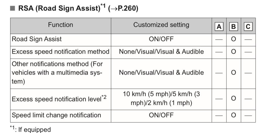

There is a setting that turns off the change of limit beep permanently. The  over speed warning can be turned off temporarily but it turns back on when you restart the car

The bottom setting for speed limit change stays off permanently IMG_2085.thumb.jpeg.2bf21231f0e763181a99ea0ef94de469.jpeg
Hadn't noticed that one! Thanks! :clapping:
Posted (edited)
Yaris X design 2024. I found this via the steering wheel controls. Use the up down toggle with the car in ready mode, to get to the settings (gear wheel) this will display a line of setting you can change the RSA one is at the end of the 1st line (looks like a magnifying glass trying to set fire to the car) press ok it will go to off only for that journey. If you press & hold the OK on the RSA setting the display comes up where you will be able to permantly turn off the spped limit change alarm but not the others, pess the return  button to exit that display. I just do that aotomaticaly at the start of each trip now

Yeah, I have mine so the change of limit warning is permanently off, and for anything more than a very short local journey I will kill the 'speeding' warning in settings. A pain, but could be worse.
