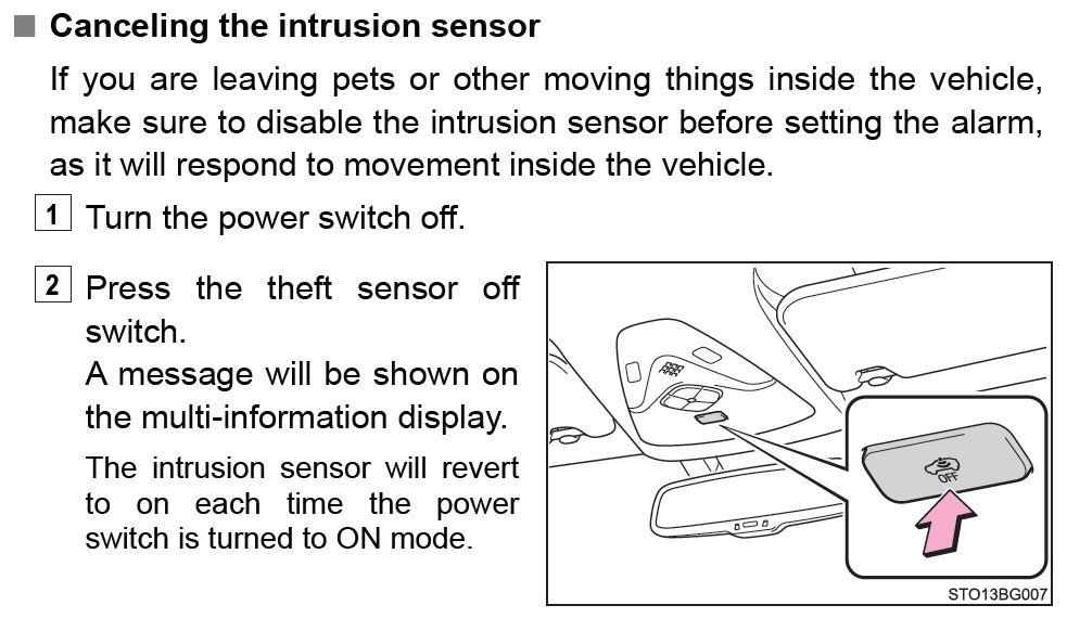

Thank you everyone.
This is from the Owners Manual
