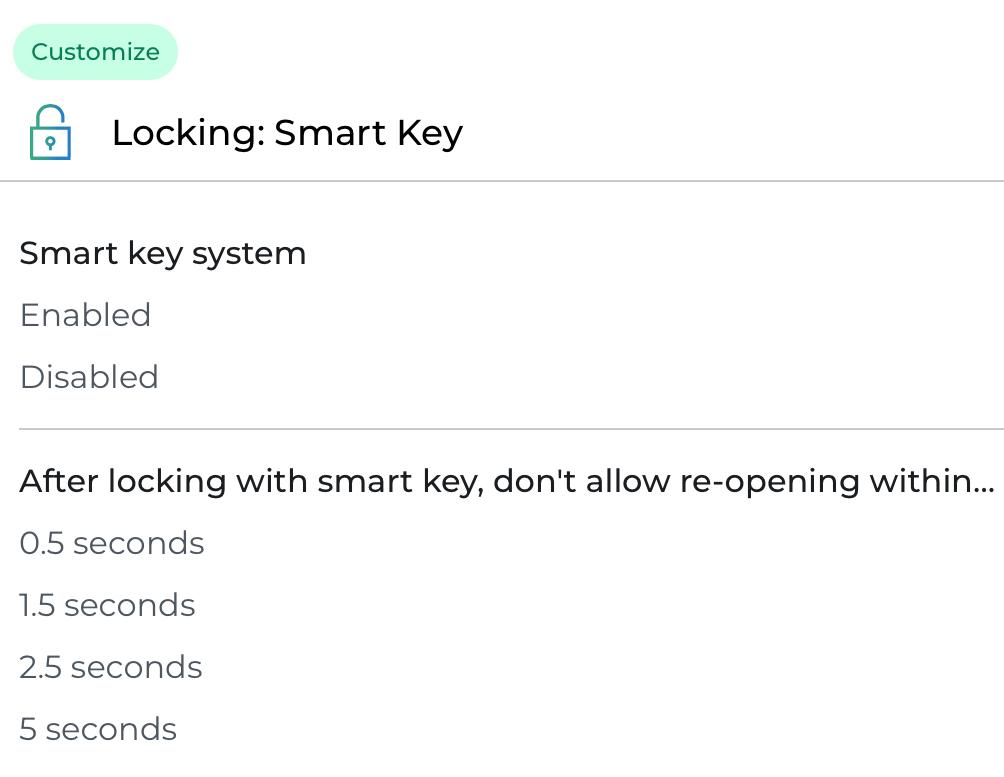

IIRC Carista is the only way to disable / enable keyless without the need to visit dealership

You can use Carista to introduce a longer delay
