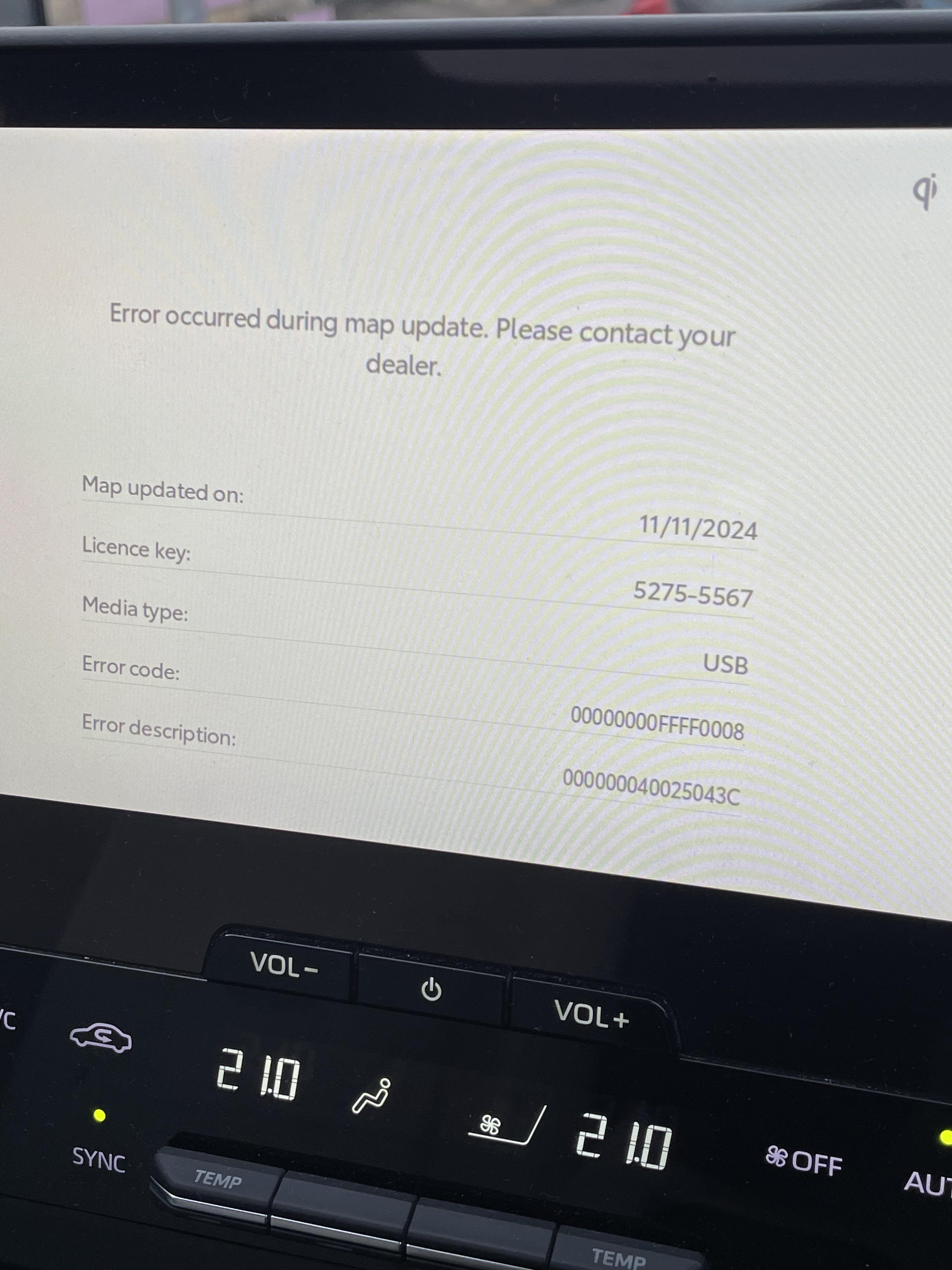

Im struggling with the update. Downloaded & put on USB stick no probs.
Started updating the map, time remaining 30-40mins, when it got down to time remaining 1 min, it seems to get stuck & stays saying 1 min. after about an hour I switched off car.
When restarting the car I reinsert USB stick & it says time remaining 20mins & gradually counts down to 1 min & gets stuck again.
Any ideas how to abort & give up??

Try with another flash drive, use fat32 system. Make sure all update files are copied in the usb disk.
I managed to update without any issue.
:sad: I used a new flash drive (USB3), previous was USB2. Update failed. can't seem to start again - so looks like a trip to the dealer
