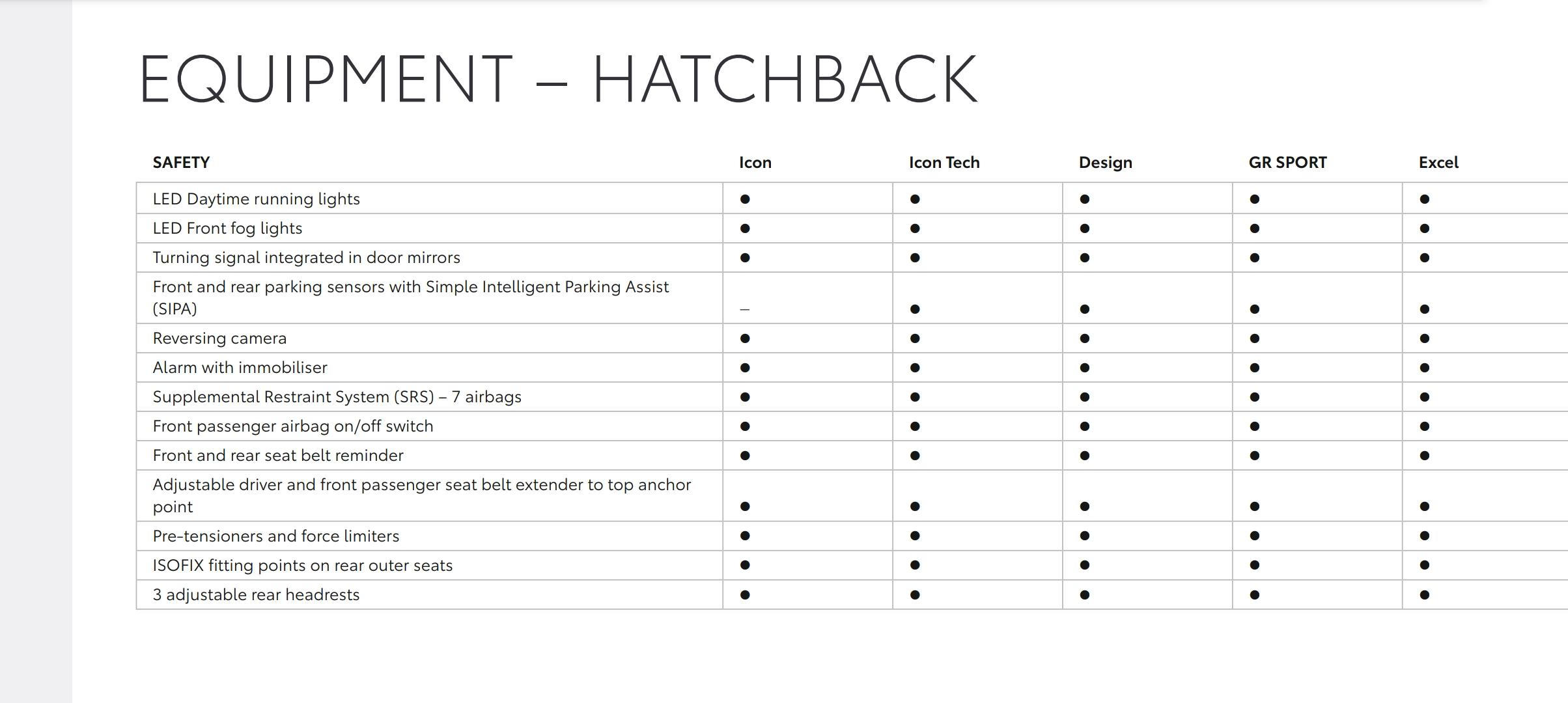

This is taken from  Oct '21 brochure. Icon, base model does not have sensors as standard  equipment. Guess the Irish spec base 'Luna' is the same.
Failing that and it is not a base model, have they been switched off in the meter settings?Screenshot_20240811_212355_Drive.thumb.jpg.d078a57b1e4b0917ee7199550f035de4.jpg

@Corolla Mike. thank you for this screenshot! I will try and figure out what model this is. It doesn’t help the manual is also no longer in the car!
