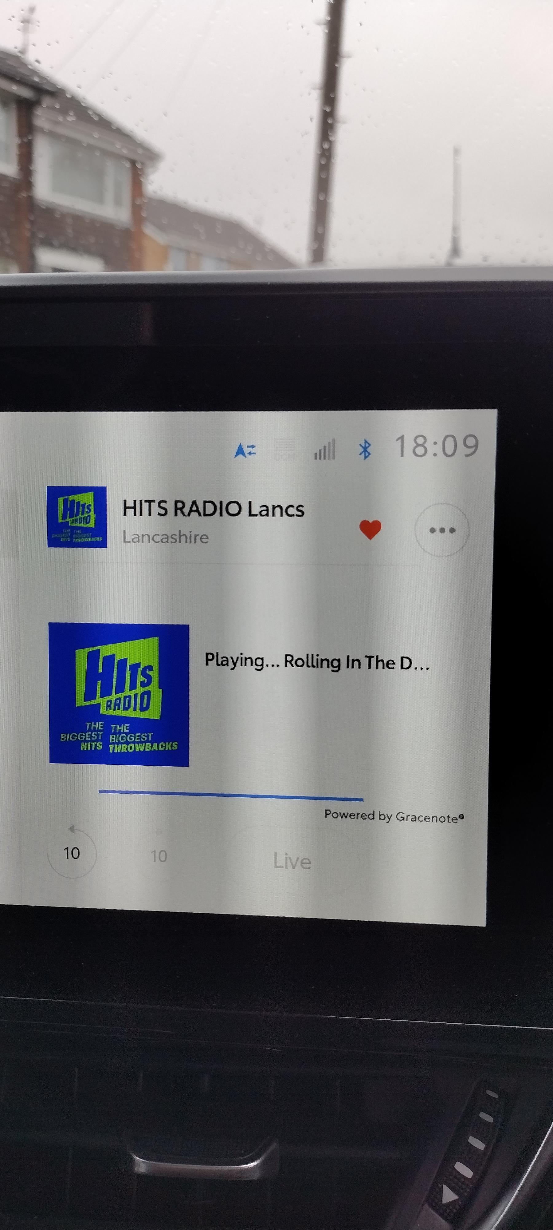

My 22 plates connected services were all working fine. Halfway to work this morning I noted that it stopped displaying album art, and the DCM icon was grayed out. I tried resetting the head unit but no change. On way home it was not grayed out but stuck on 1 bar and nothing connected worked. After 10 mins it grayed out again. Is there anything I can try, or is the DCM failed.
IMG_20240815_180919689.thumb.jpg.e3bc81c4f274232feda4fb8736a8c929.jpgIMG_20240815_180919689.thumb.jpg.e3bc81c4f274232feda4fb8736a8c929.jpg
Of note the eSOS light is green, and the blue arrow is not greyed out, if that means anything.
