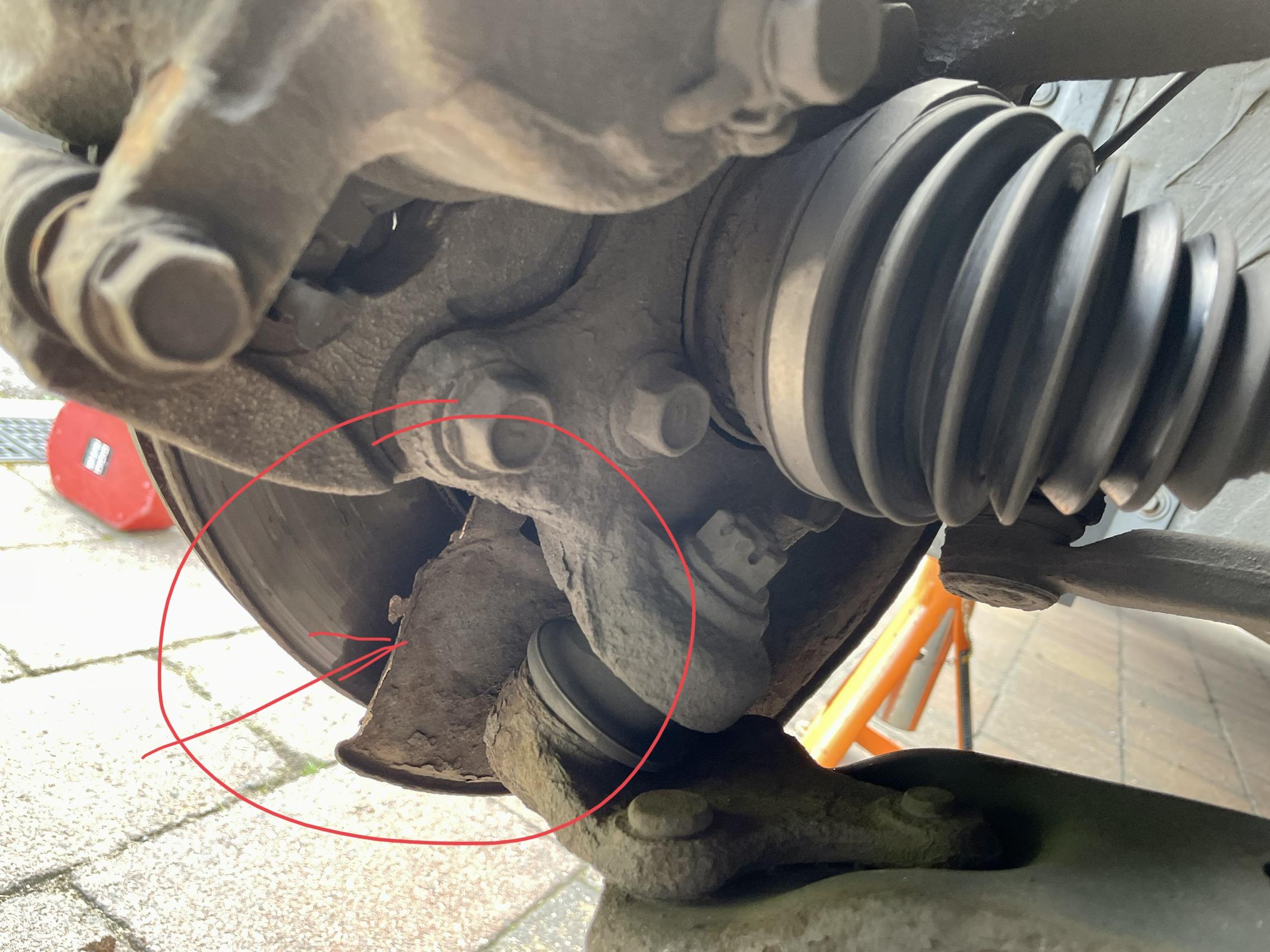

No had the wheels off and blown out with air pressure but still the same
There are metal protectors behind the discs if any these get rusted and bent from road debris or air stream they may touch the discs and cause these noises.
These can be bent during brake discs and pads replacement too.
