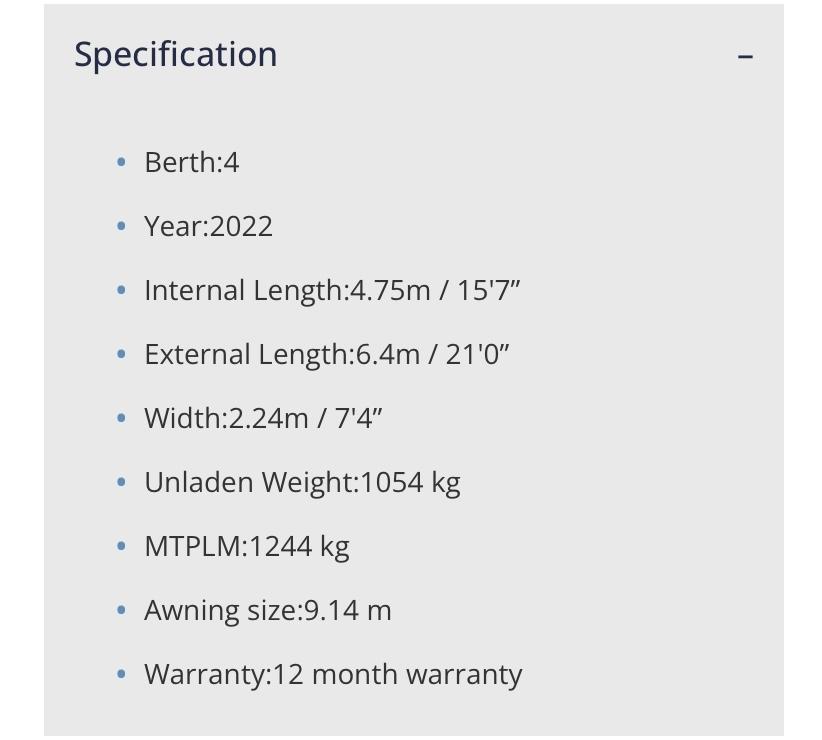

Hi all , sorry if this has been asked in the past , does anyone know if I’d beable to tow a caravan with a 2017 2litre petrol rav4 - it the non hybrid version 4 wheel drive model I’m interested in with cvt .
the caravan would be a 4 birth single axle, or would I be better with either of the hybrids both new and previous versions.

I've no idea of the weight of your caravan ...
With that MTPLM you SHOULD be fine. I note you have sent me a PM so this is my response. As an aside the towing ability of a Skoda Superb is utterly irrelevant unless you are looking for a Superb (they are good tow cars). The only way to confirm towing weight ability is to check the weights on the VIN plate usually found in the driver door jamb on most cars. The RAV4.5 PHEV towing weight is 1500kg albeit the new GR sport is lower for unfathomable reasons.
