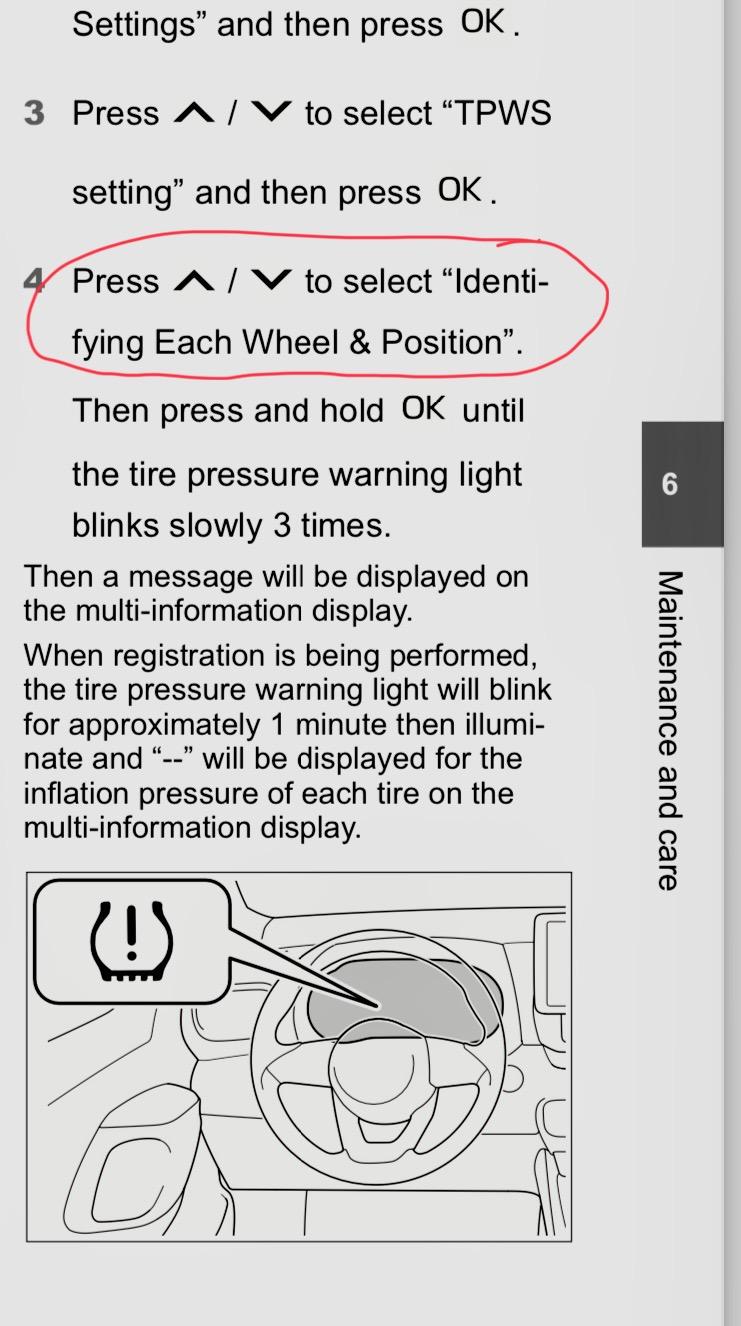

if you swap the wheels around, is there a way to reset the system to recognise the new wheel positions?
Have swapped front to back on the MK3 and nothing needs doing though there wasn't an individual pressure indicator. Would assume nothing needs doing on the mk4 also, but haven't done it so don't know for sure.
Latest 2024 mk4 monitors each wheel independently, so the system needs to know location of each sensor. This is easily set in the TPMS settings menu.
You shouldn't need to do anything - When you turn on the car, it starts pinging each of the TPMS sensors to figure out which one is on what wheel; That's partly why it will only show --- for a couple of minutes before displaying the pressures.
My wheels usually get all mixed up every time I get new tyres (I used to identify them visually by the pattern of kerbing marks on my old cars :laugh: ) and I've never had to reset anything for my Mk4 to figure out what wheel is where.
Once the sensors have been coded to the car, the only reason to do a reset is to set the desired pressure threshold for the warning.
The car needs to be told which sensor is where. My wheels were switched and I had to go into settings (after a couple of days) to assign the sensors to the wheels.
That's weird, I don't think I've seen such a menu on mine :confused1:
Mine just seems to do it itself automatically...!
How do you assign the sensors to wheels, does it show a list of their hardware IDs for you to select...? :confused1:
  • Like 5
