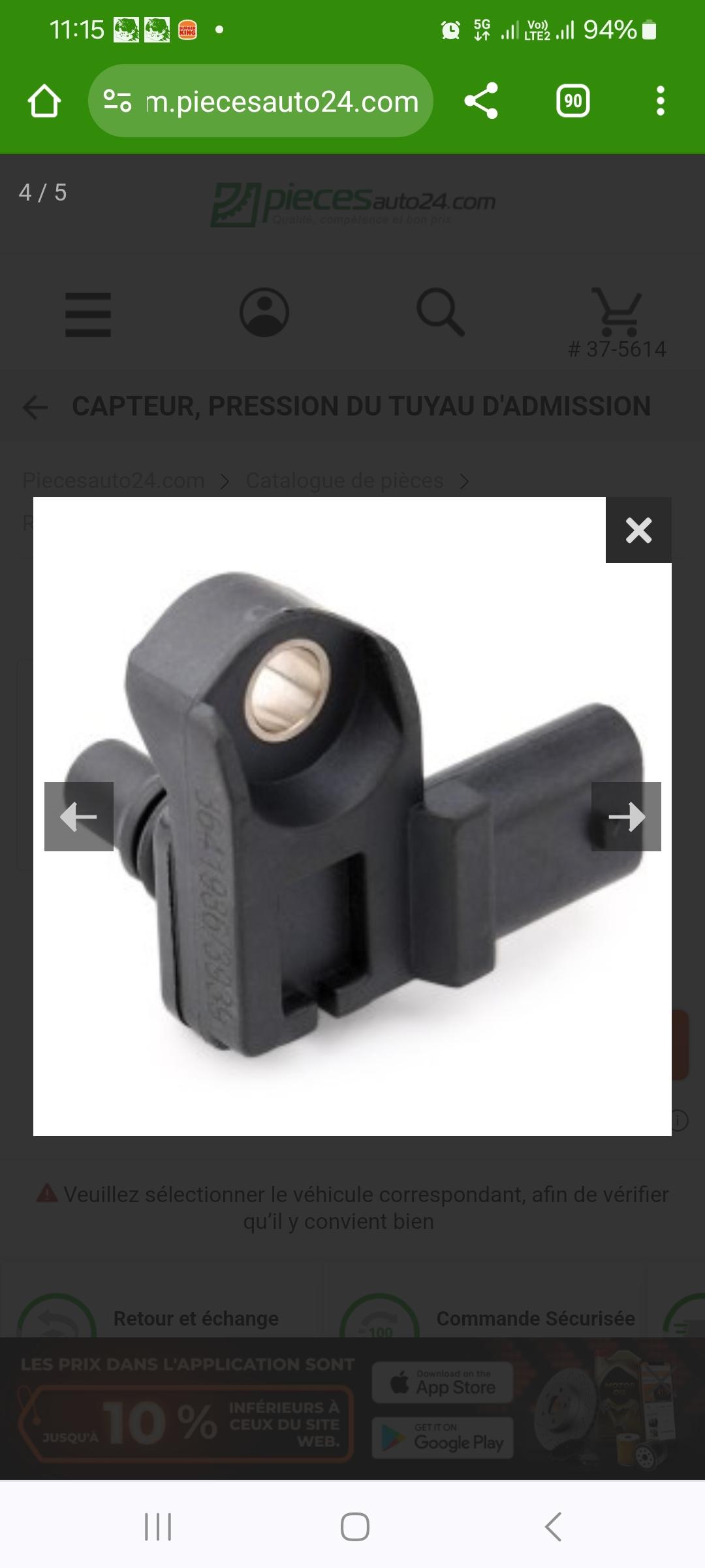

I also add that I have a problem (I think carbon and oil) in the intake manifold which regularly blocks the pressure sensor and causes my fuel consumption to increase, I clean it very regularly

Can you put a picture of the sensor that you clean? I haven't done that ever
Good morning , so Toyota has been doing tests for 1 year and finally they talked to me about the segmentation..., there they tested the injectors to see if they were good because they told me that this would surely affect the decision of the guarantee relax and they are good so if they decide to change the unit (which I hope) the bill will be lower for them because the injectors are good... for the sensor I could take you a photo this afternoon, it is located just in front of the oil gauge, it is a star screw, if you do not see tell me again this afternoon I will take you a photo thank you for all your advice, it still hurts
