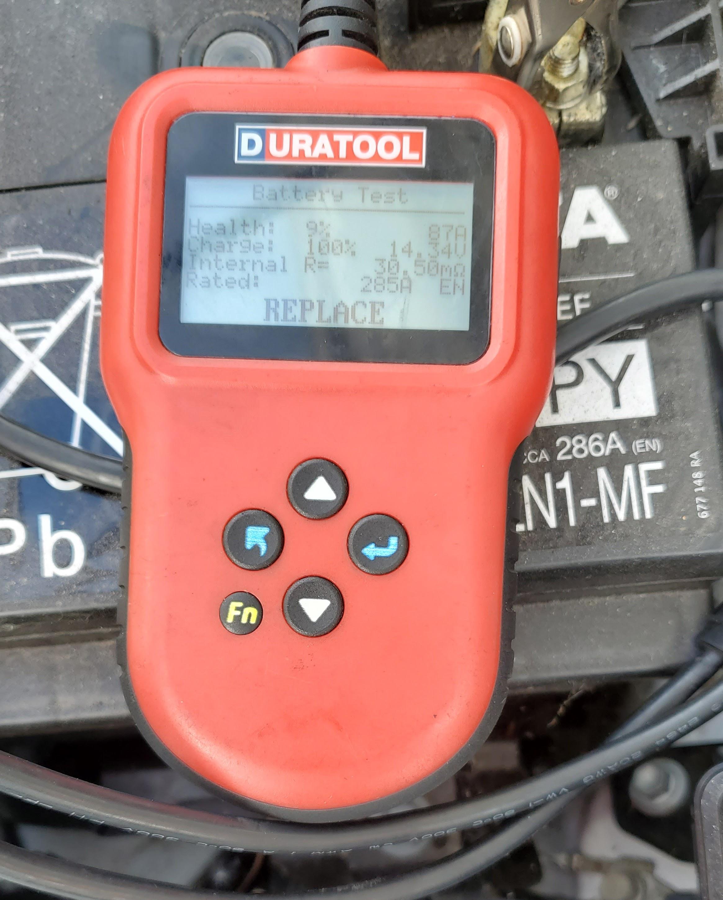

Thanks, trouble is I've no proof of the bad cell diagnosis. I photographed his meter when the car was back up and running as attached. Don't know how to interpret readings 3 and 4. It does say Replace though which isn't great on a 2.5 year old car.

Hi Roger, if you tell the dealer the course of events including the diagnosis I'm sure they'll test the Battery themselves and should replace it under warranty.

Given that the Green Flag guy's meter showed 7.8 volts and Bad Cell initially but that on here I've read that Toyota are likely to test the Battery and if no fault found charge me £100 for the pleasure, any views on my options.
