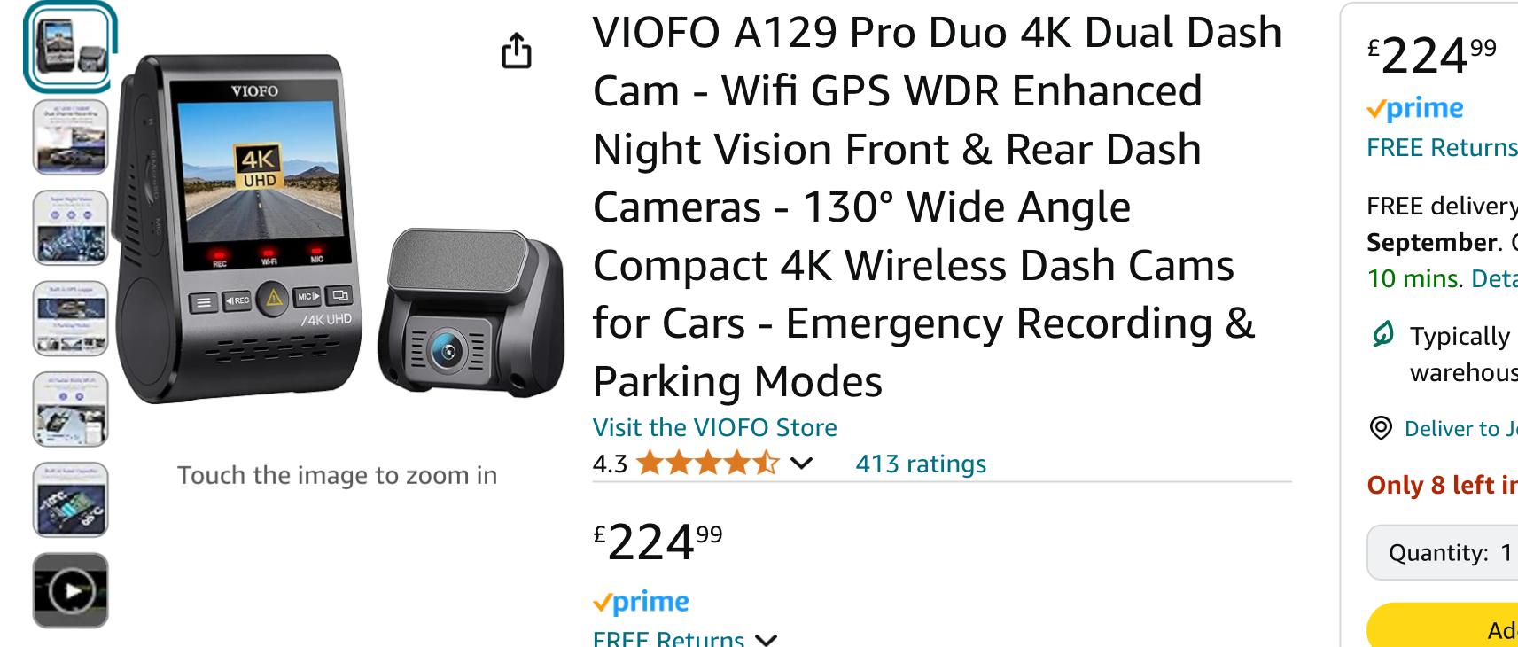

Viofo 4k front and 2k rear to be fitted next week
Viofo Amazon

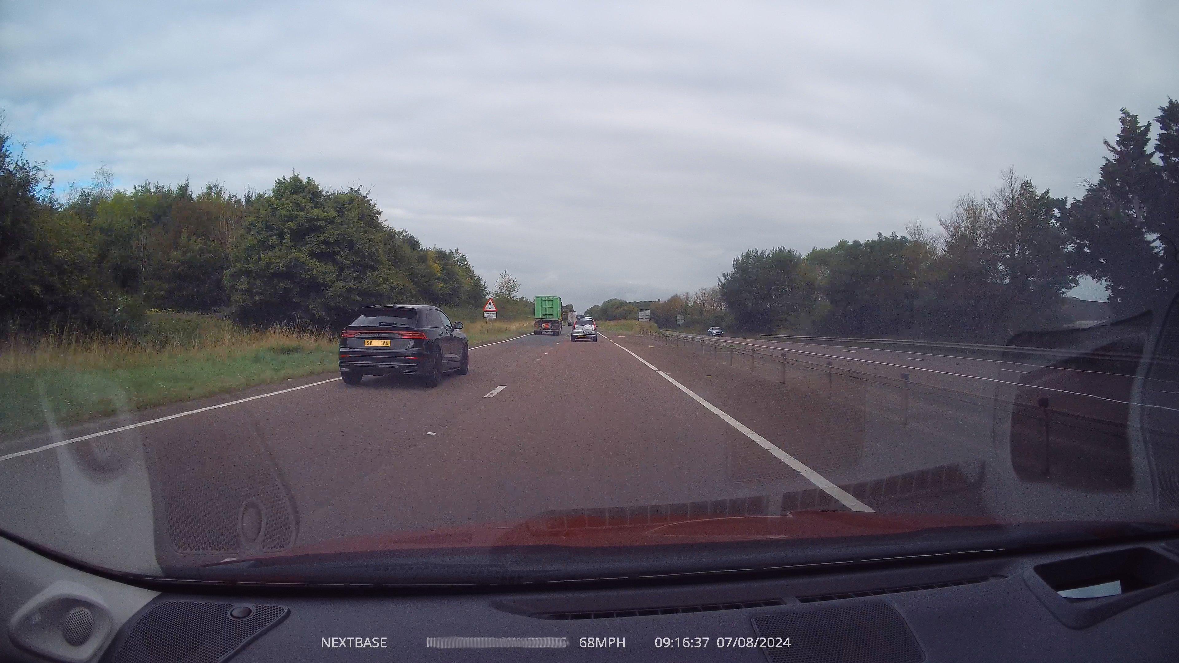

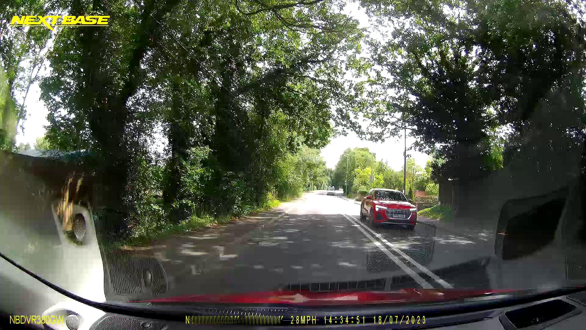

If this is the Nextbase 380GW, bear in mind the resolution is 1080p. We had this fitted to our Yaris, and yes, it is discreet.
I had a 322GW fitted in my C-HR and this also recorded in 1080p.
I cannot fault the reliability of the Nextbase cameras. I have however, replaced both the 380GW and the 322GW with the Nextbase 622GW models which gives 4K resolution. I found the 380GW and 322GW did not give me the ability to record in a high enough resolution. I also have the Nextbase rear cameras fitted to both cars and wanted the higher resolution here too.
So, what I am trying to say, is go for the Nextbase camera. They are brilliant. But, make sure you are happy with the resolution.
I have attached some images of the 1080 resolution and the 4k resolution. In the 1080p, you can't make out the registration number of the car, while in the 4K, the reg number can be clearly seen (I have had to blur some characters of the number plate to offer some privacy).

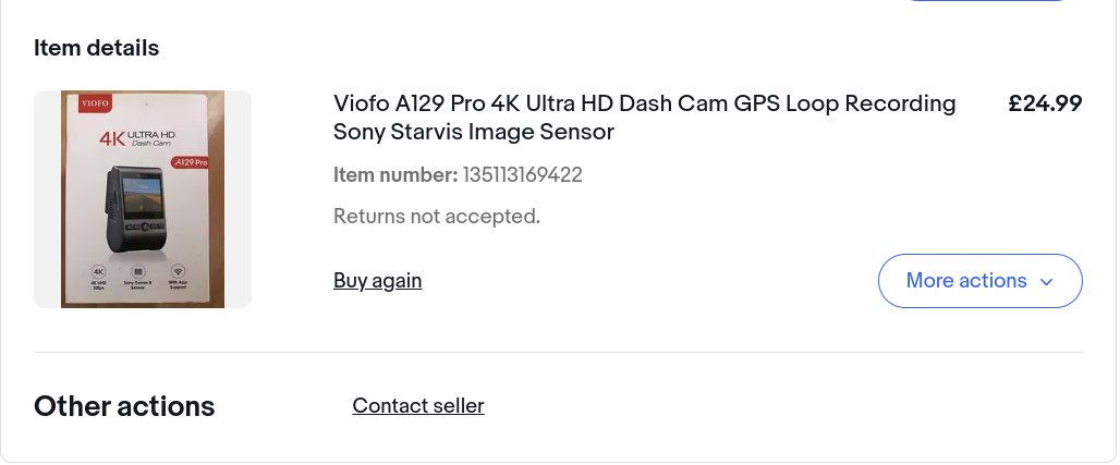

I doubt you'll be disappointed, I bought the 2k version of your 4k front camera & found it to be pretty good, The I spotted on eBay the 4K version for £25, brand new & unused in the box but camera only, no accessories, I got a mount from Aliexpress for about £8 and a hardwire kit from Temu for about the same price.
I'm going to hardwire the 2k one for the rear as it seems you can't connect two "front" cameras together.

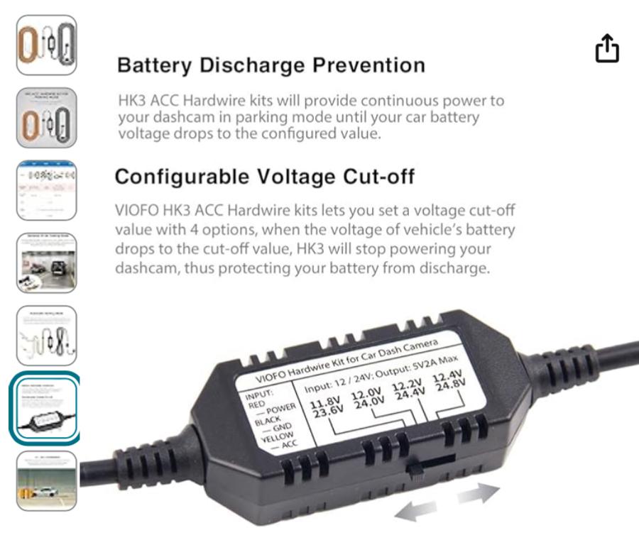

I’m just thinking that, with todays cars ( not just Toyota) Battery issues seem to be more prevalent, most of the dash cam hardwire kits have Battery shut off mode to save the cars Battery if it gets to a certain voltage it will shut off the camera, with todays smaller ( it seems) and all the modern gadgets, the voltage will soon drop therefore not giving long in parking mode..
The Viofo wiring kit includes a voltage cut-off device which you can set at what level of voltage the device will trigger.
12.2 volts is, according to the Yuasa Battery sticker, 50% discharge so I'll set mine to that when wiring in next week.

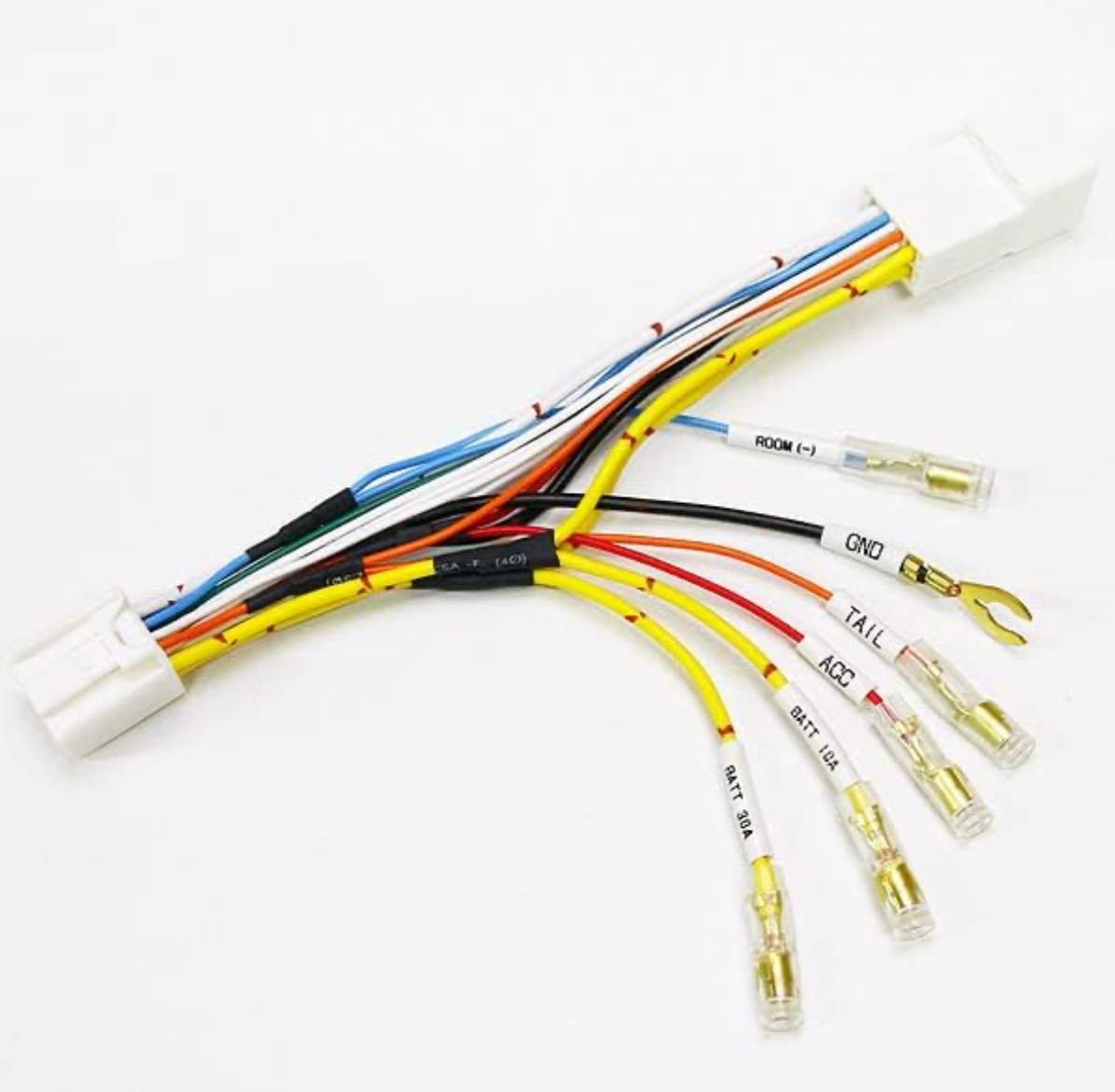

I also bought this from Amazon Japan to enable easier install of the power supply connections.
