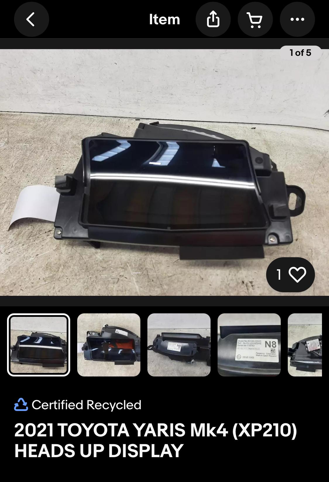

Very curious if the head-up display can be added to my XP210 Yaris 2021
Do I need anything additional?

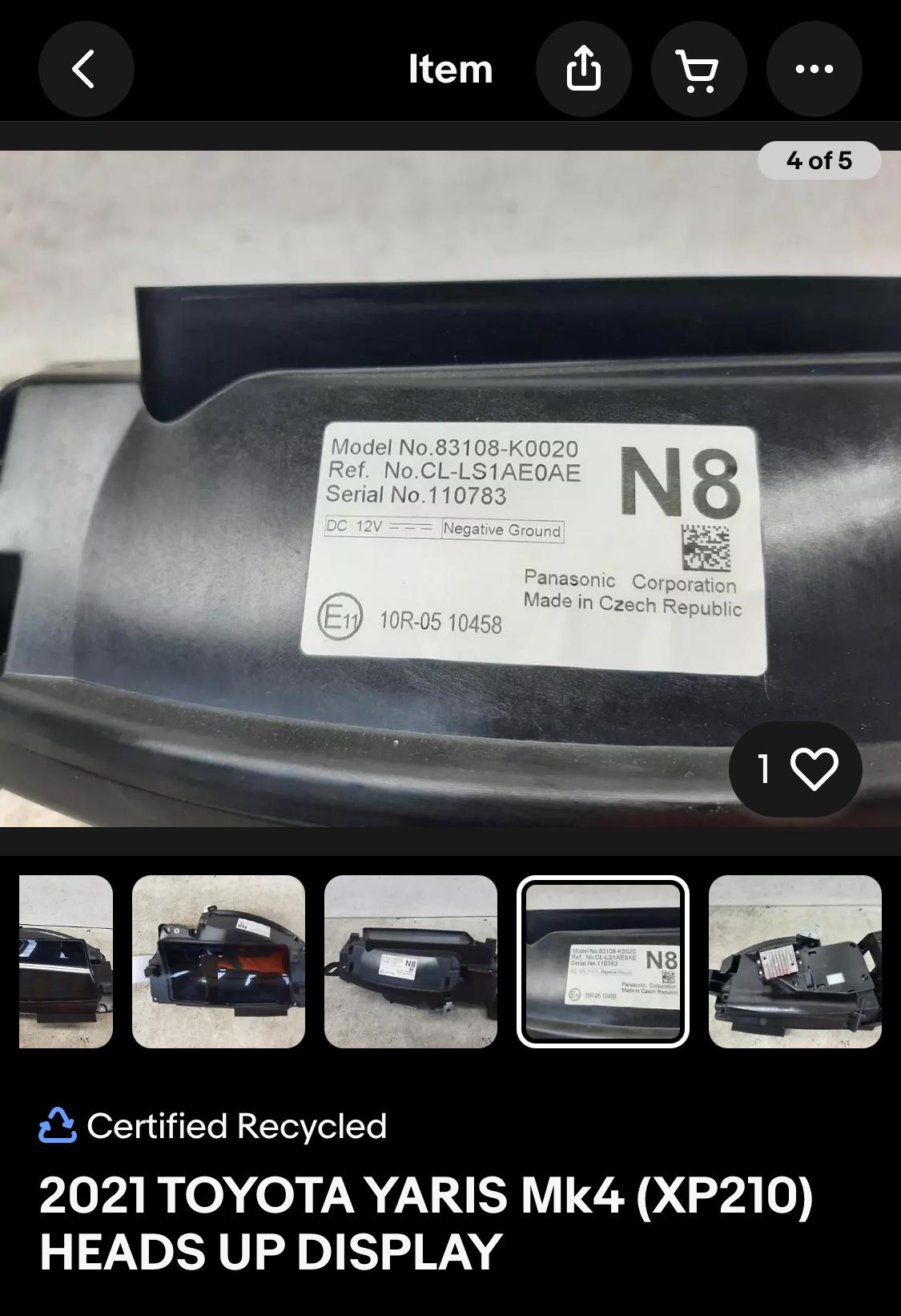

yes you can, but the dashboard trim is not cheap, you can cut your existing dash as the hud cut out is marked on the rear of the trim
55313-K0060 with HUD, centre speaker
55414-K0020 hud trim
the windscreen is also different, but you can get a stick on film if required

It's not difficult to work out the connections all I know is the dash trim is between £250-450 depending on the part number - be aware of the dash trim (K0010 and K0020) as it does not have the centre speaker (Yeah)
LHD and RHD are also different

I was hoping is more cheap to do as the display was cheap but the installation seems overly complicated
Many thanks for your answers
