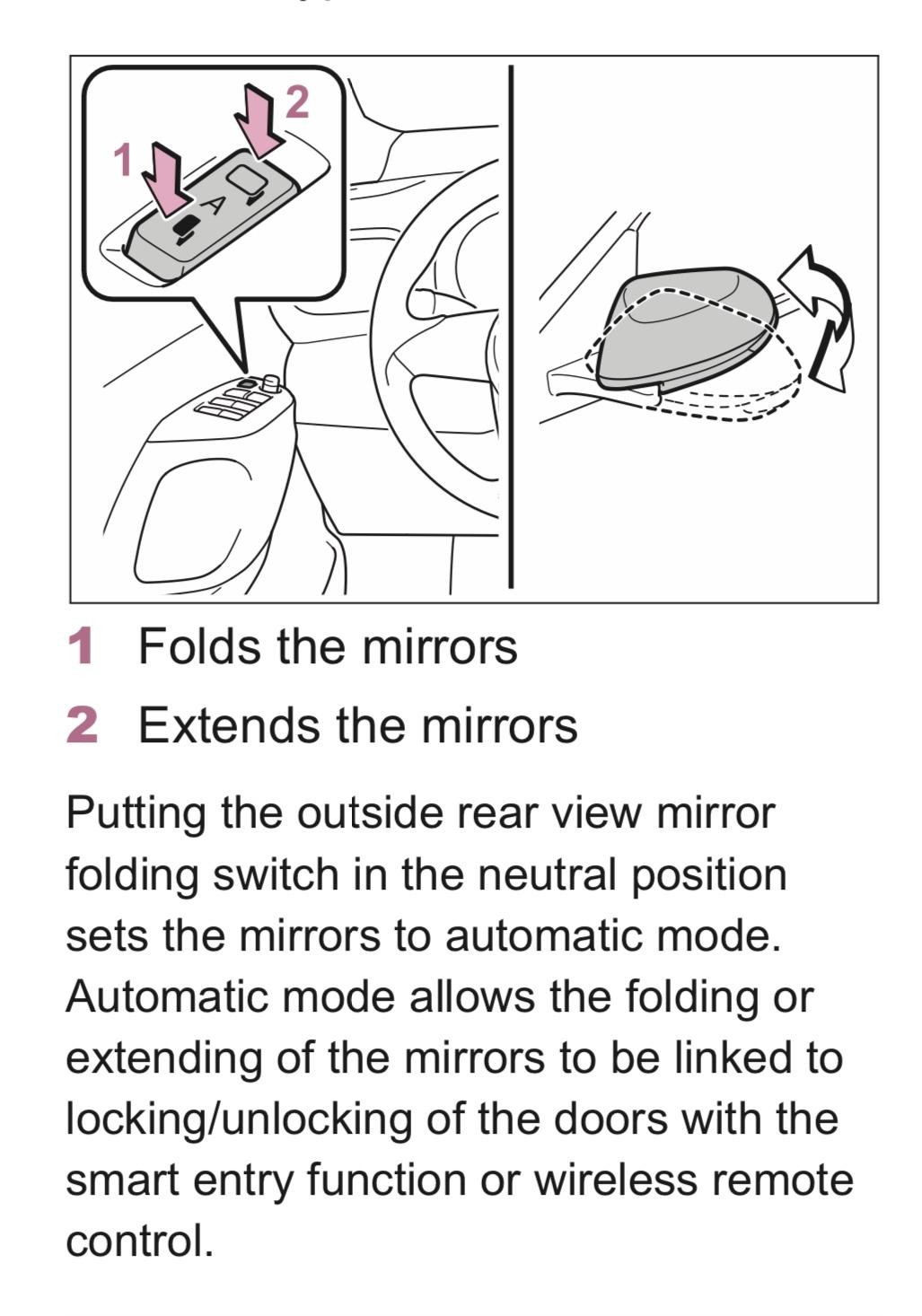

Rocker switch on drivers door (forward of window switches and to right side). Press back of switch (nearest you) to fold the mirrors, press front of switch to extend the mirrors, and leave the switch in its neutral (middle) position for auto mode (where locking of car will fold the mirrors in, and unlocking will extend the mirrors)
From the manual

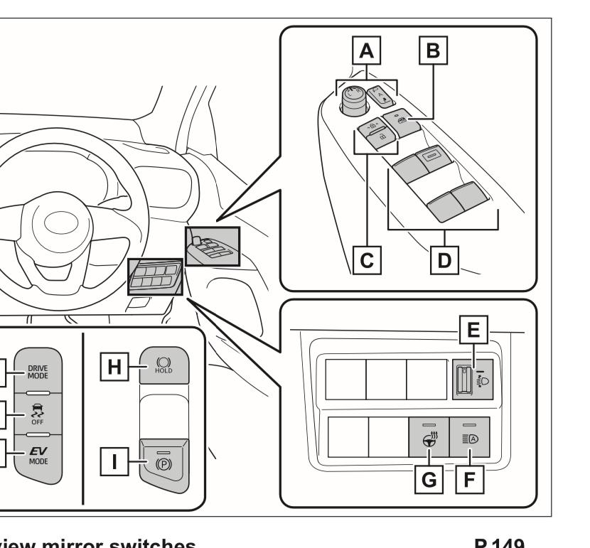

lts the rocker switch label A
