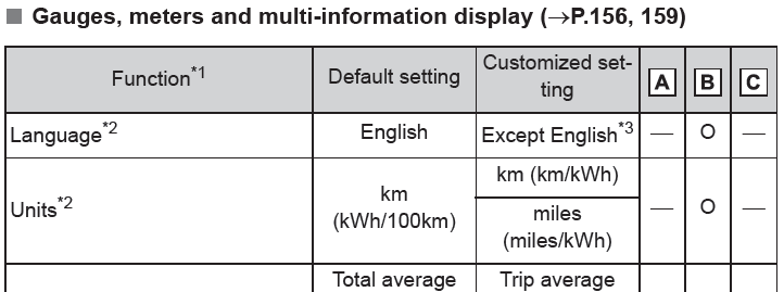

Yes, absolutely - it follows exactly the same pattern as all other Toyotas sold in the UK and as documented in the Owner's Manual:
I can tell that you are still having difficulty in believing the almost unbelievable ... 😉

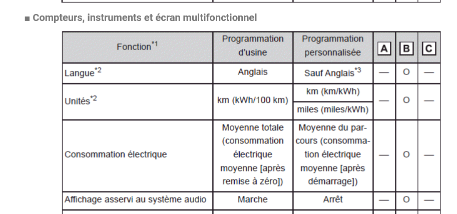

Sorry to be going on about all this Philip. My paper users' manual in French runs to 258 pages, and there is only one section at number 9.
But I managed to track down Section 9.2 on an online version of the manual, and this is the comparable piece to the bit you showed.
You'll see that when it comes to units, all that is customizable is to change the power consumption from a default number of kWh to travel 100km (which is the same as the normal ICE measure of litres/100km), to EITHER km per kWh OR miles per kWh.
That's almost rubbing it in!
This came from here: https://www.toyobz4x.com/personnalisation-133.html
