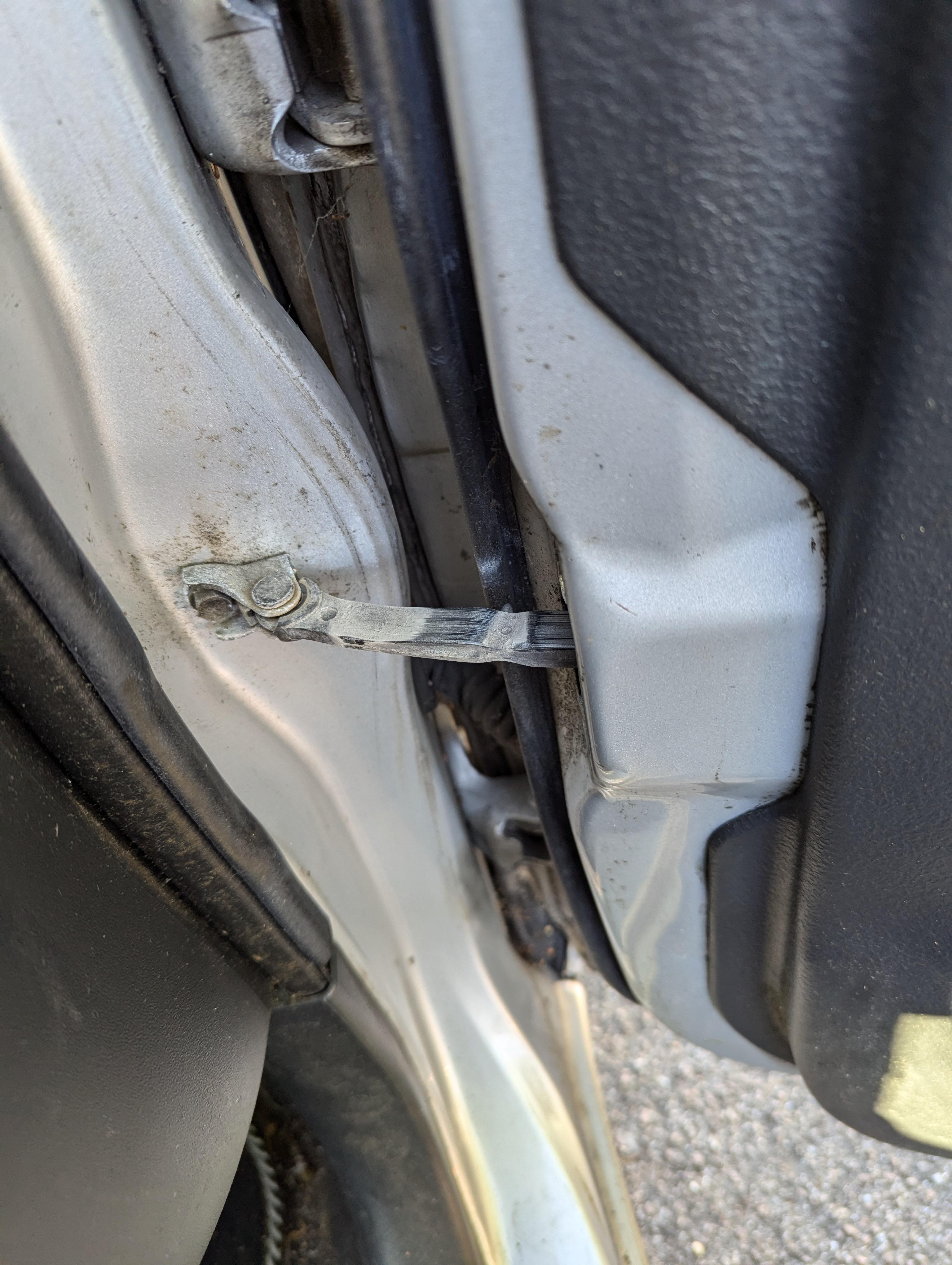

Hi does anyone know how to change or tighten this driver's door hinge when I open the door it just swings open without any restriction unlike the passenger door which has resistance and stops half way.

1 bolt from the frame (on the photo) and 2 bolts from the door (but you should to take off the door panel, because it can be installed only from the inside of the door)
p.s. yes, you can still expand/open it and replace the 2 plastic parts inside, but in my opinion, it is easier to buy a new one

Hi mate thanks so much for the response for this. Is it just the door card like when changing the wing mirror i just pull that off and then easy access to this part? Do you think this will be a main dealer part or can i get from eBay maybe what is this part called.

You can try to clean it up thoroughly with brake cleaner and brush. Try to clean deep inside the door too.
It looks like in the silver metal part there will be a ball on spring that moves up and down to get into the grove that eventually slows down the door.
If you get it cleaned properly, than lube with wd -40 silicone spray you might be able to get it work again.
If not here is the part number 68610-0D010

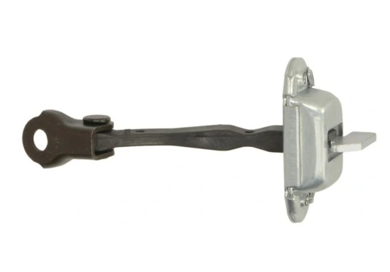

Hi again im just about to buy this part and want to double check its right although does look right to me.

Hi,
you need to confirm with the seller. Perhaps it’s the same and it might be a part that fits to many Toyota models but the seller need to compare the numbers . Have you tried to fix your one?
I don't it's fixable that thing is knackered I'm sure I drive for a living and the car is old already and on top of that I get in and out about 50 times a day. The person sent me a part number which seems accurate because looking at that part in the car it looks exactly same worst case scenario I will return it. The part number given to me matches the part number for this item exactly.
Good, you can do that . 👍
