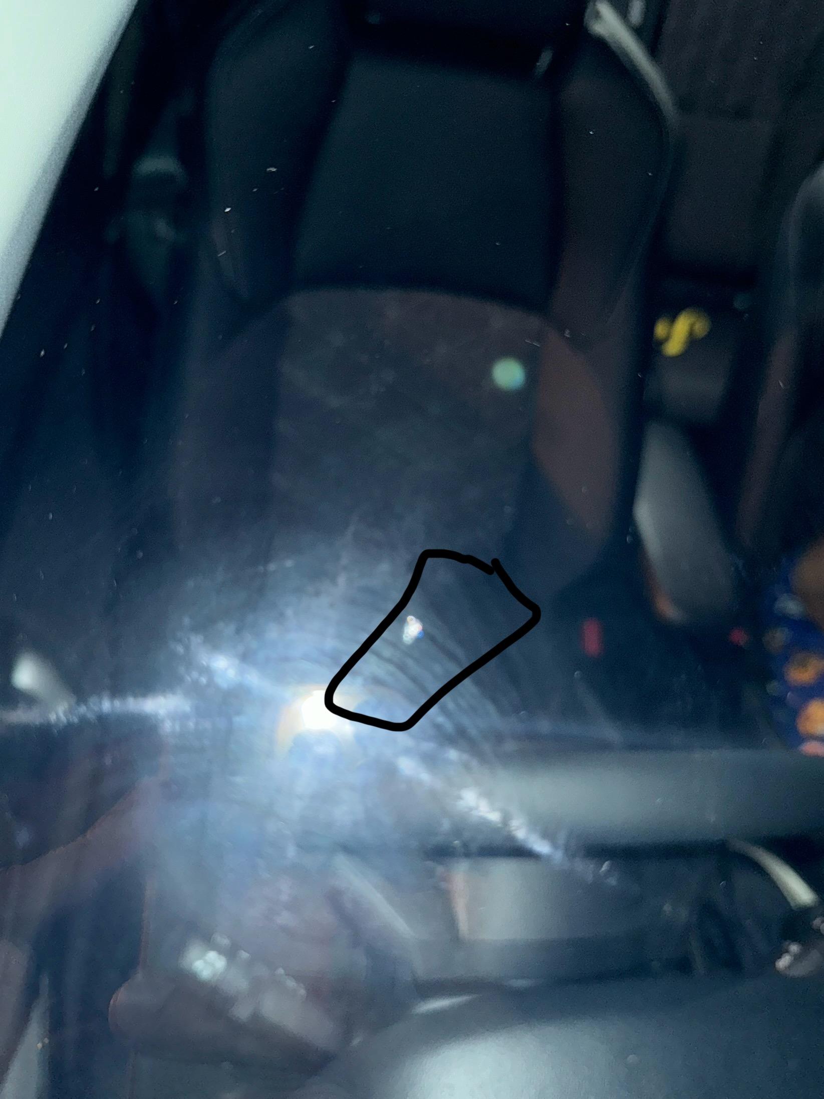

I am devastated when I found out a small chip on screen within 9 days of getting a new car.How unlucky! I have only driven it locally and totally unsure whether its new or old?
Its on PCP , what should I do ?

Its so disheartening to hear your story as well.I have insurance which covers repair and replacement.
will dealership charge?
Should I go with repair or replacement?
How is the quality of repair?Does these chips disappear altogether?
You'd have to ask the dealership - They might repair it for free given you've only had it a few days. If they charge you may as well go through insurance as they shouldn't charge to fix a small chip.
The chip will remain visible, but smaller. The fill is mainly to stop it getting any worse, as if it does you may need a new windscreen, which is a real faff and you have to pay whatever your windscreen excess is.

It will depend on what is legal. If a repair will be legal then that's what your insurers, or possibly dealer, will do. If not then it's a new screen and you'll be looking at an insurance job.
If a repair is legal but you don't like the result then a new screen will be at your own expense. And Murphy's Law dictates that within a short time you'll get another chip anyway, so don't even think about going there.

mine is so small I think about 2mm ,I am thinking to leave it.Because roads are full of grit.And if they make it big it will be a nuisance.
Do
you think I should tell Toyota or Insurance?
It's a tricky thing to judge. A chip can develop into a crack that propagates over time and can then be illegal quite quickly. Yours appears to be in front of the driver so there is a 10mm limit.
A repair may not make it invisible, or even any better, but it should stop water getting in and then freezing, which can start or enlarge any crack - just as happens with potholes on the road. So it's worth thinking about getting it fixed before winter.
Thats a very good advice.I have got insurance cover and will be making a claim today to get this repaired.
