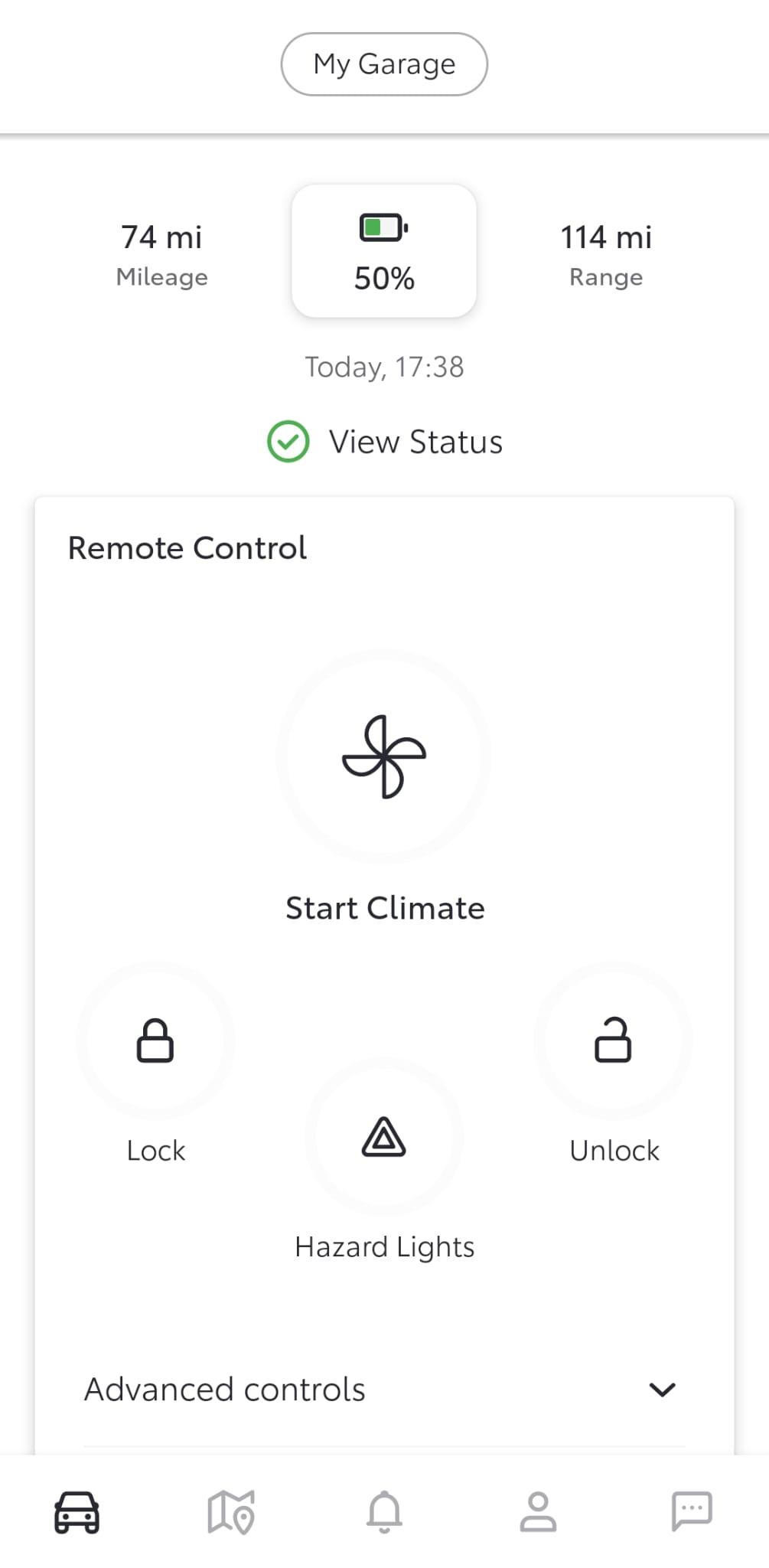

Hi, could you please give me some advice regarding the Toyota bz4x battery's performance?
My recently purchased Toyota BZ4X Premier Edition AWD has an excellent appearance and drive, but I have some concerns regarding the battery's current performance. I fully charged it at the showroom and drove 75 miles; the Battery is now at 50%.
The salesperson at the showroom stated that it would improve after a few charging cycles were completed.

The actual range you get will depend very much on your journey type and how the car is driven. Toyota provide a Range Calculator that gives some idea as to what range you might expect.
You don't give the % SoC when you set out, nor the originally estimated range. But the key point here is that they are estimates based on recent driving experience. If your journey type is reasonably consistent the estimating accuracy will improve over time.
At this point all you can really do is charge it up again and monitor it 'properly' to see whether you experience lies within the typical ranges suggested by the Calculator ...

Unless you are driving somewhere where the temperature is -25c, using 50% in only 75 miles means something is wrong. You say you charged it full at the dealers - as phillip24 says, are you sure it was at 100%.

But that’s normal . You had traveled 74 miles and you have 114 remaining miles of range which will make up to 188.
If the car been used in inefficient way, rain, wind motorway speeds etc the total range will decrease. After few more charges and different use with less motorways the car will settle to a higher range. I don’t see anything to be worried about. 👌

That shows estimates of 50% SoC and estimated range of 114 miles - giving an estimated range of 228 miles on a full charge. While that's not exactly 'great' its within specification / expectation for the bZ4X ...

Hi guys! I am grateful  for your answer. I charged the battery from 50% to 100% and then drove 9 miles; the vehicle now shows a remaining charge of 96%. Is it good?
You seem to be going round in circles. Your screen shot shows the car wasn’t at 100% when you collected it. The total miles driven on the car was 74 yet the forecast was 114 miles with 50% remaining. Therefore the total expected range was more like 228 miles. You fully charged it and used 4% to do 9 miles. Two things - what did it say at 100% ? And 9 miles / 4% =225 miles. I bet it forecast 225+. The more you use it the more accurate the forecast will be as it learns from previous consumptions.
If the usable battery is say 68 kw then that equates to 3.3 miles / kw which is good against the majority of current EV’s.
Many thanks for your thorough explanation. On delivery, Battery fully charged to 100% and I drove 74 miles. However, after the Battery dropped to 50%, I fully recharged it again  and conducted some tests, running 9 miles. I'm curious to know how you assumed the information from the screenshot thatwasn't fully charged.

Your original screenshot shows that you had so far covered 74 miles and then had a 50% charge with an estimated range of 114 miles:
On 9/22/2024 at 10:19 PM, Piccasso74 said:
I drove in all typical weather, which was 15°C.
There is no evidence from this screen shot that the car was originally charged to 100%. It has only covered 74 miles when a 50% charge should be sufficient for 114 miles of range so the simplest assumption would be that it wasn't fully charged from the outset.
If it was fully charged - and you say that you started with 100% charge - then you appear to have lost / used around 40 miles range as part of that initial usage. This could be through inefficient driving (high speed / hard acceleration), heavy use of the car's electrical systems while stationary or a combination of the two. Only you will know what actually happened ... 😉
Simple arithmetic would suggest to me that you actually set out with around an 80% charge - but I wasn't there!!!

The truth is, my car arrived fully charged up to 100% due to waiting for the installation of a level 2 home charger, and I was disappointed by the lower mileage compared to the expectations within this model bz4x's range. I have now scheduled a Battery check appointment with Toyota. Hopefully they will sort it out. The big question is, what else will I do if they can't resolve this issue?

Piccaso74 - show the screen shot you posted to the dealer. He will no doubt explain to you how a forecast range to go of 114 miles with the Battery at 50% is really in line with expectations - a real world ange of 228 miles you didn’t say what the forecast range was when you charged to 100% - but you did say driving 9 miles only took 4% which is a total range of 225 miles so why do you think there is something wrong with the Battery ?
