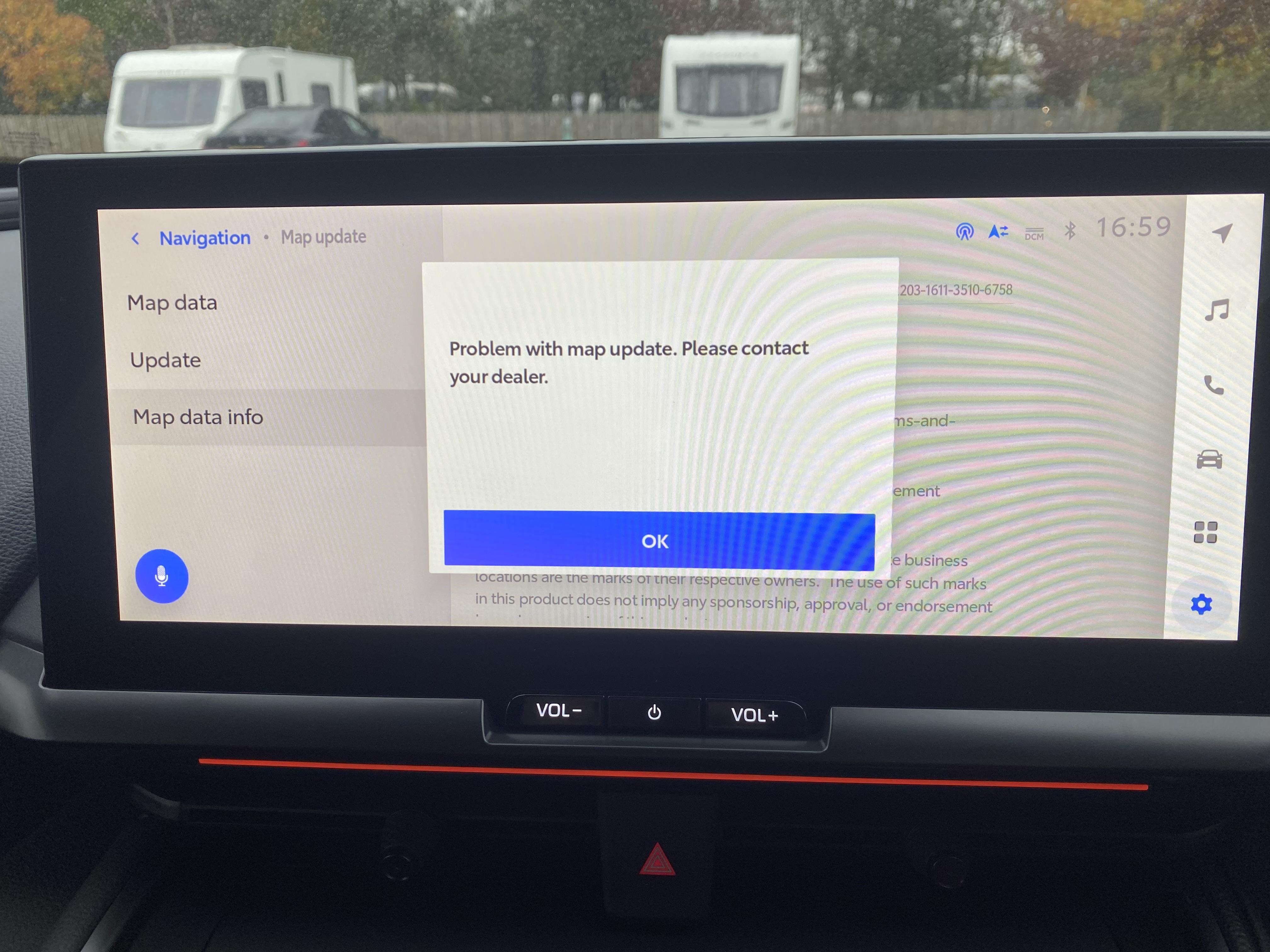

Hi everyone,
I've recently picked up my new daily, a plug in CHR, an Excel version if that makes a difference.
I've been perplexed by the following messages regarding map versions. I don't notice anything "wrong" with the version it has but I just don't like error messages 😂
Is there a way to download to usb and perform a manual update?
Grateful for any thoughts. You might be thinking "contact the dealer?" I'm looking for other thoughts 🤭
Got the same message a couple of days ago - there is a Multimedia Unit recall/customer service campaign so check with your dealer and/or the online checker to see if your car is affected. My car is 6 weeks old and I’m booked in next week to get it done.
I posted a thread on this earlier this week 👍
https://www.toyota.co.uk/owners/vehicle-information/recall-checker
Ooh! Thank you for the update, I looked on the recall page but it said something about not being able to identify my vehicle.

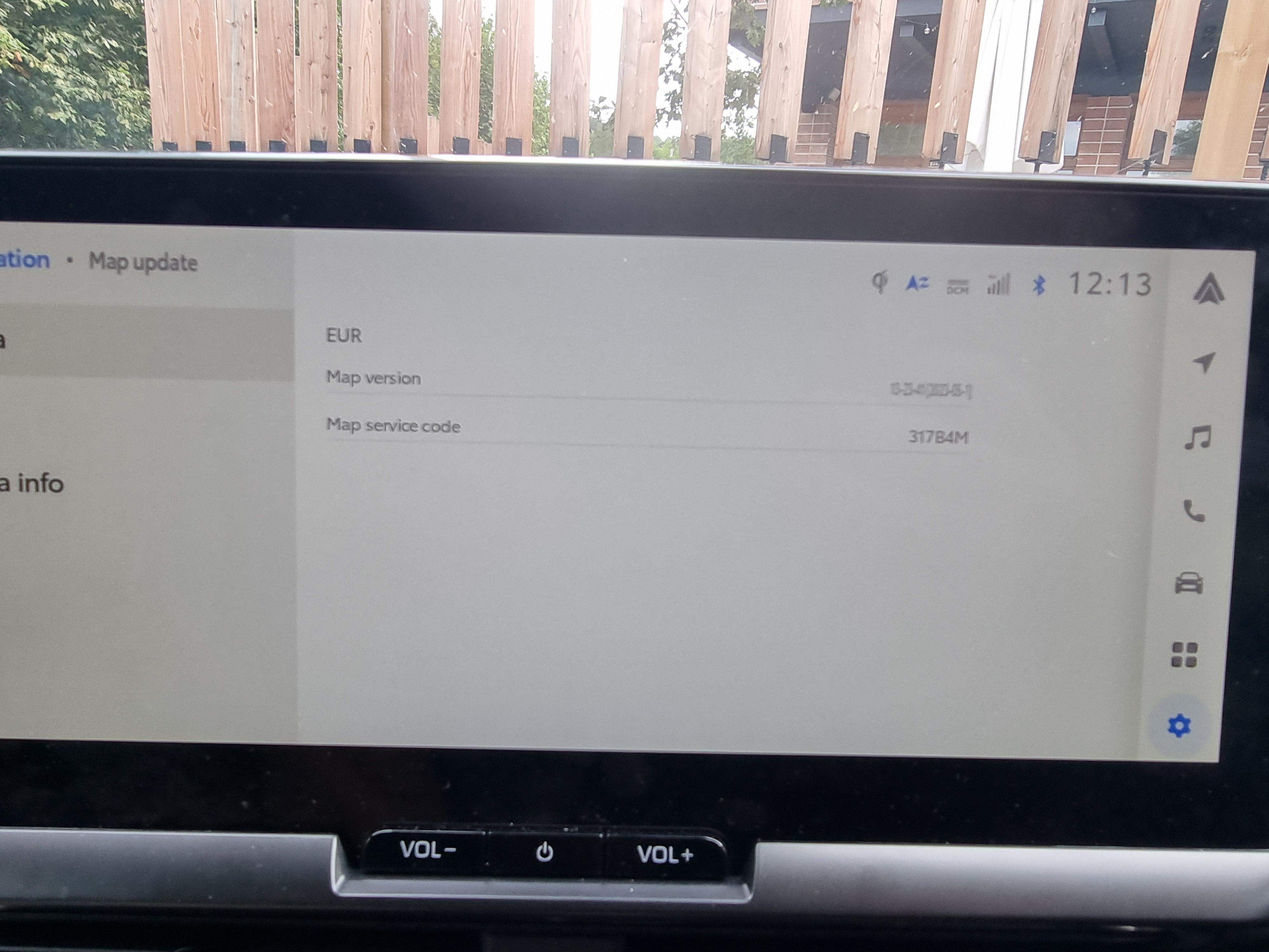

I had my unit replaced under warranty and it cam back like this, There has been a map update, which `I completed successfully it didn't change before the update or after, but the map version changed

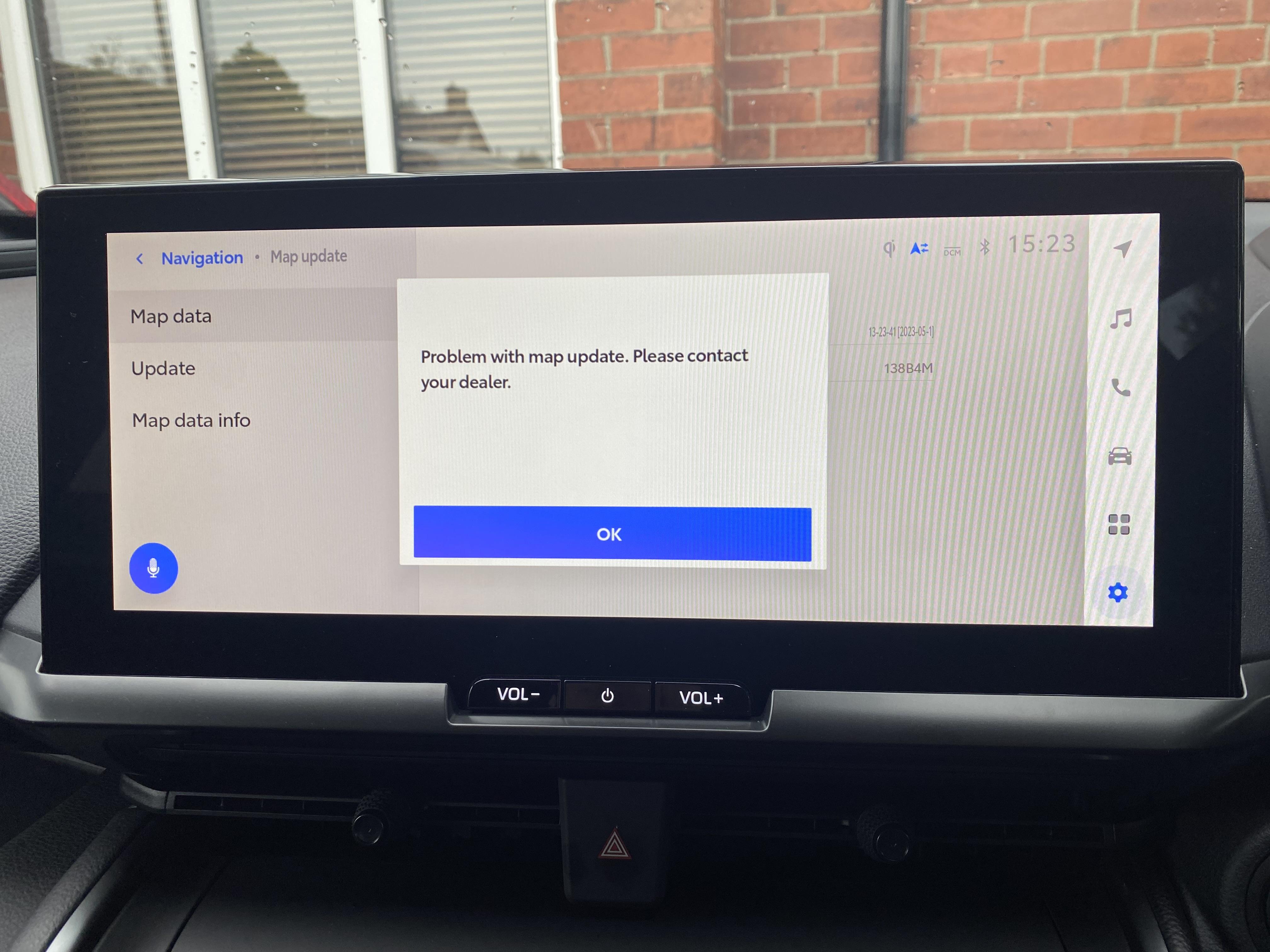

I still can't update from the menu, it throws the same error 🙄 ah well.

I got a further email from Toyota CS yesterday regarding this pop-up window - they are now saying my car should go to the dealer to get this sorted 🤦‍♂️

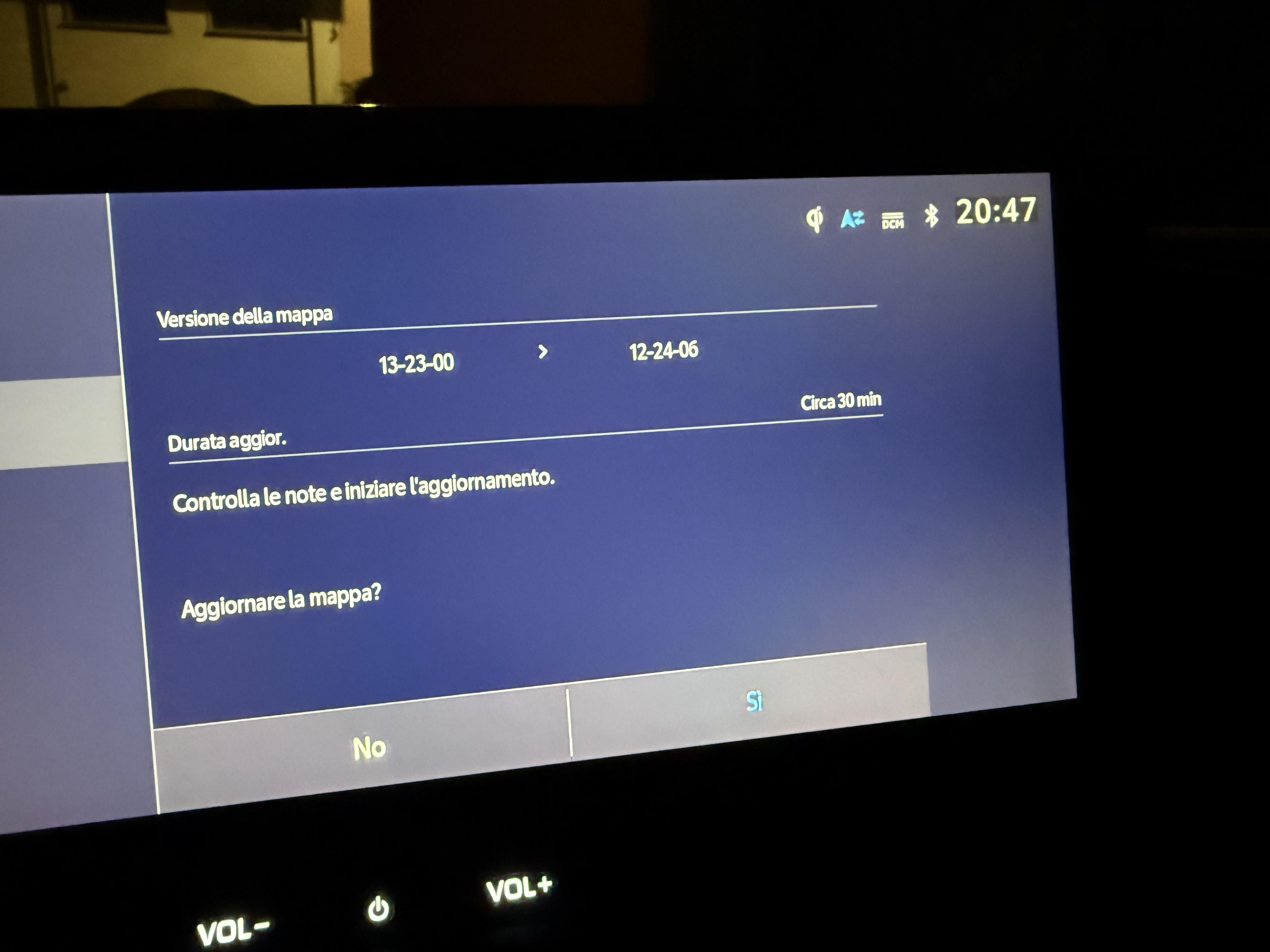

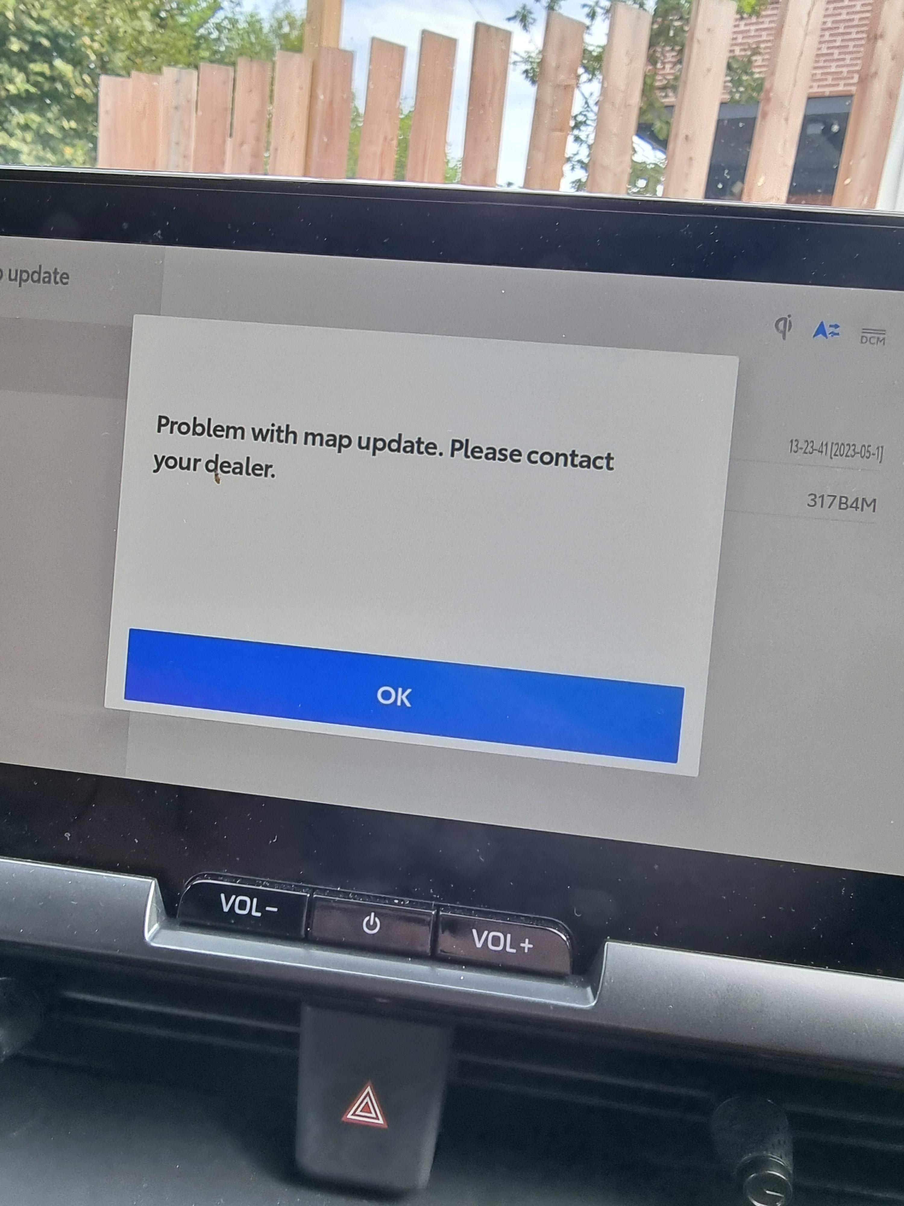

Hi everyone, I downloaded the update, put it on the USB, started it and after the fake 30 minutes which became 60 minutes, it gave me an error and should I contact the retailer? Have others had my problem?
If you've got a spare 60 minutes then would be interested to see the error message that you got @Teo1983. What version does it say that you have already?
This thread discusses the map update for the Smart Connect system. Your profile states that you have a 2017 C-HR which, if it is a European car, will have an earlier Toyota Touch system and require a different map update. So, can you:
  • Let us know where in the world you are
  • Confirm that you have a 2017 C-HR (or otherwise)
  • Let us know what multimedia system you have
  • Let us know which map update you attempted to install ... 😉
(The time taken to update the earlier Touch 2 system was around 75 minutes ... )

I have MY24 Lounge Premiere Italian Version
OK, you've updated your profile now too ... 😉
That's pretty much what mine said (only in English) and after about 40 minutes I had an updated map.
Clearly the USB stick is not all bad because it recognises that there's an update to be applied. You could try reformatting and rewriting the USB drive or trying with a different USB drive to check for a 'glitch' in the preparation of the drive. Or, as it suggests, make it the dealer's problem ...
