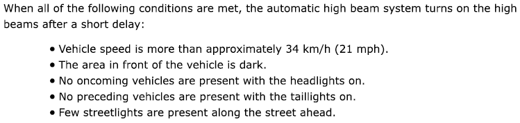

This is from the manual, hope it helps.
Thanks. Yes, definitely. That's from the english manual, I have the swedish and it doesn't say a word about any conditions!

That sounds like Toyota has actually listened and dropped the speeds by around 10 mph. Does anyone know when it was changed?
My village is unlit, and driving through it at night was impossible on auto lights, because 30 mph was never enough to switch the lights on. Without street lights. It was impossible to see far enough at that speed

Yes that's what I get with mine, I had a look in the full electronic manual on the Toyota UK website (lot more detail than the paper manual) and it goes into a lot of detail on how it works - full beams come on around 37mph and then go off at around 25mph. Doesn't look like there's any options to change that, it's not a user config item.
If you haven't got the full electronic manual then it's worth downloading a copy and there's some config options and other stuff not included in the shortened paper manual.
