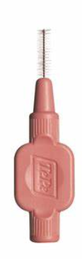

Washer jets on my Auris can be a regular problem. I've had the gush of water barely making it up the screen. Water squirting out to the side, water over the roof, you name it can do it. Instant easy fix...
If your washer nozzle is the molded plastic type with what seems to be just a hole or slit where the water emerges then try one of those little dental brushes. If you haven't any of these then a child's tiny paint brush. Anything with bristles that will go into the jet. Give it a good spin and twirl. Use kitchen cleaner spray on the bristles as well.
I have to regularly do this every few months to keep them good. I assume its limescale buildup inside.
