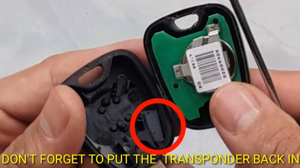

get a new remote PCB but remember the chip (transponder)
all the PCB does is the remote locking which is user-programable, and the immobiliser is a passive chip
you can still use the car without the PCB
there is a number on the PCB either 73373067C or similar, stick this number into eBay, it's a common Peugoet/Citroen (PSA) part

Thanks for your reply. Only seem to be able to find used PCB which could be a problem programming?
no problem - the remote locking is user programable swap the board go to the car and program it
