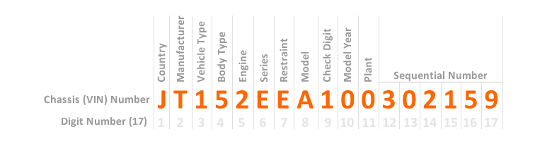

This may help but seeing that your VIN comes back with errors when using a vin decoder, it may not help 😢.
Although there are exceptions to the rule, the first three digits usually refer to the country of manufacture, the vehicle maker and the vehicle type.
For example, if you check the first letter of the code, you’ll see J references Japan, S references England, while V identifies France. Turkey gets an N, while Thailand and South Africa get an M or an A; this is where most of the new Hilux’s are produced.
On earlier models the second letter is usually T, which describes Toyota, the third describes which group of cars (or sometimes which chassis type) the vehicle sits on.
The next six numbers reference the car’s body style and engine and gearbox, while the remaining eight are combination unique to the car, listing the year the car was made, the factory it was produced in and where it came in the production process.

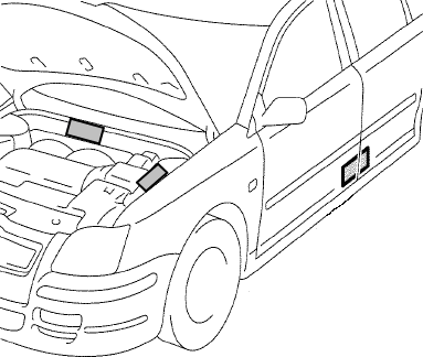

(1) Identify the Vehicle
Before you can select the right manual, you must accurately identify the vehicle to be repaired by locating the Model Code on the Vehicle Identification Plate. The plate is typically located in the engine compartment but may also be located elsewhere on the vehicle. The illustration shows typical locations for vehicle identity plates on Toyota or Lexus vehicles.

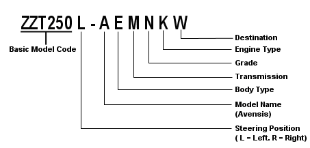

(2) The Model Code
The vehicle identity plate contains the vehicle identity number, engine number and model code. The vehicle Model Code, similar to that shown below provides a complete identification of the vehicle type including model, engine, transmission and body type.
Only the basic model code is required to search for manuals. In this example, ZZT250 provides sufficient information to search for Avensis manuals.
A complete explanation of the model code is provided within the first few pages of each New Car Features manual. These can be viewed on-line by selecting the appropriate model (in this case Avensis) and New Car Features from the Publication Type drop-down lists.
