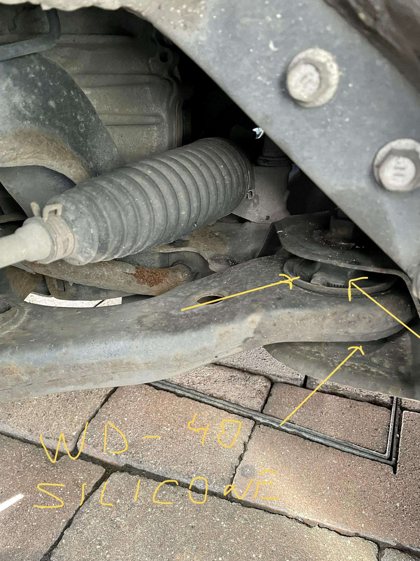

Has anyone experienced a note on service sheet re the lower arm bushes inof  need renew in near future due to deterioration , perishing and squeaking on a yaris hybred 2019 with only 44,000 miles.
Hi,
other low miles owners also suffer these problems. Sometimes is just the mot testers looking for extra work. Other time these can fail prematurely as a result of over loading ( going faster over speed bumps) and salt from the winter drives.  Best is to turn steering full lock side to side and get pictures and share with us. And while doing so, take a silicone spray like yellow wd-40, and spray the bushes thoroughly. This will clean any debris locked between the rubber opening and lube the rubber and stop any squeaking noises you are getting. 👍
Thanks for the comments and will attach photos later
