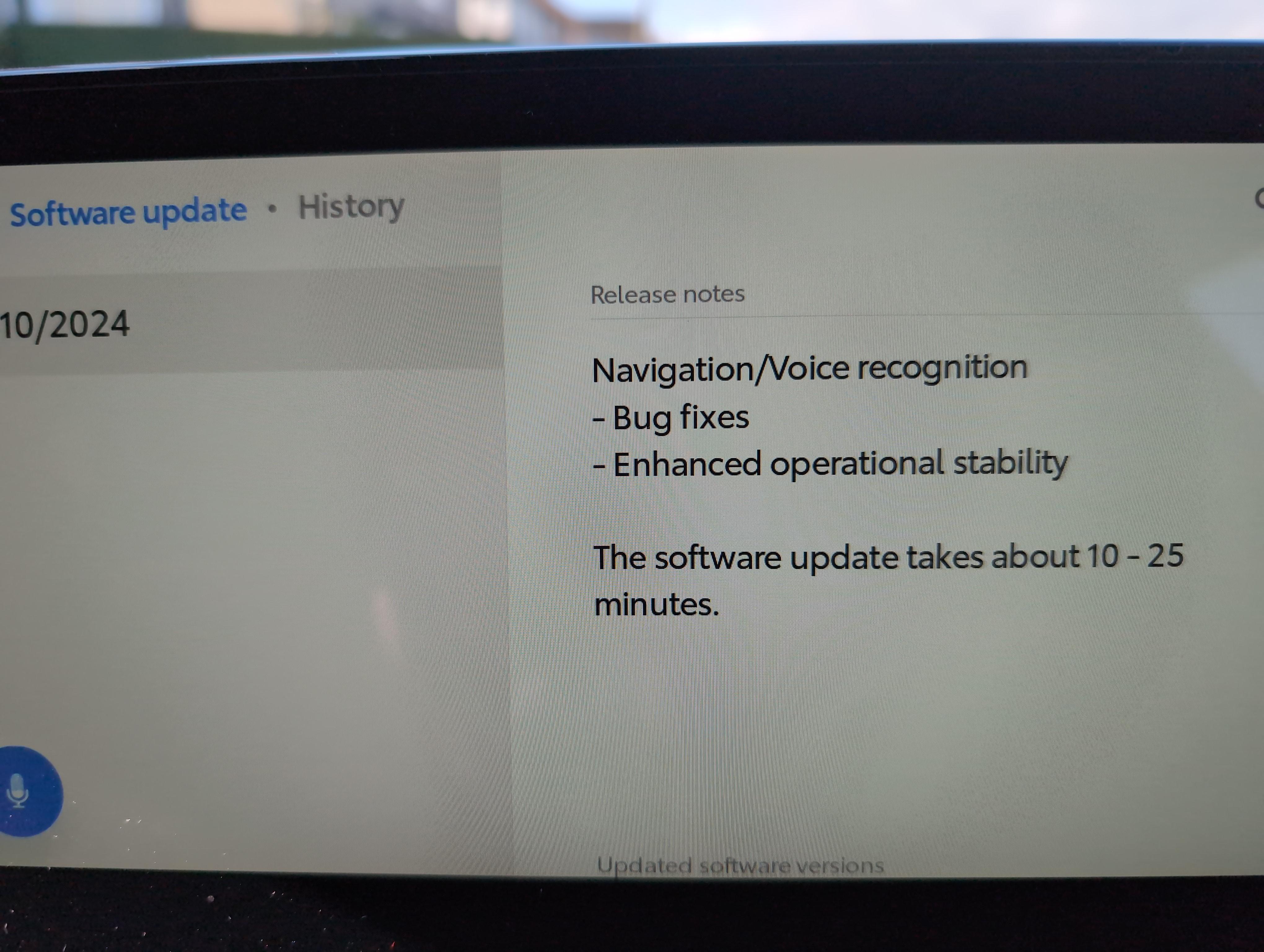

I have just pulled up at my son's house in Huddersfield whilst waiting for him.  I checked for a software update, there was an over the air update  available. This is the first OTA since I purchased the car in March. When I've tried it previously it just came up with an error saying "consult your dealer" I can't remember the exact wording but it stated, system stability improvements, voice recognition imrovements and navigation improvements. The update suggest 25 minutes to complete. Currently at 23 minutes. Now completed ok
Note when I first checked for update is said none available but after 20 seconds it came up

2024 C-HR 1.8 Excel, registered March this year.The update as far as I remember started with ZG but I didn't take note of it before the update. The photo I uploaded was a shot of the update history after it had completed.
