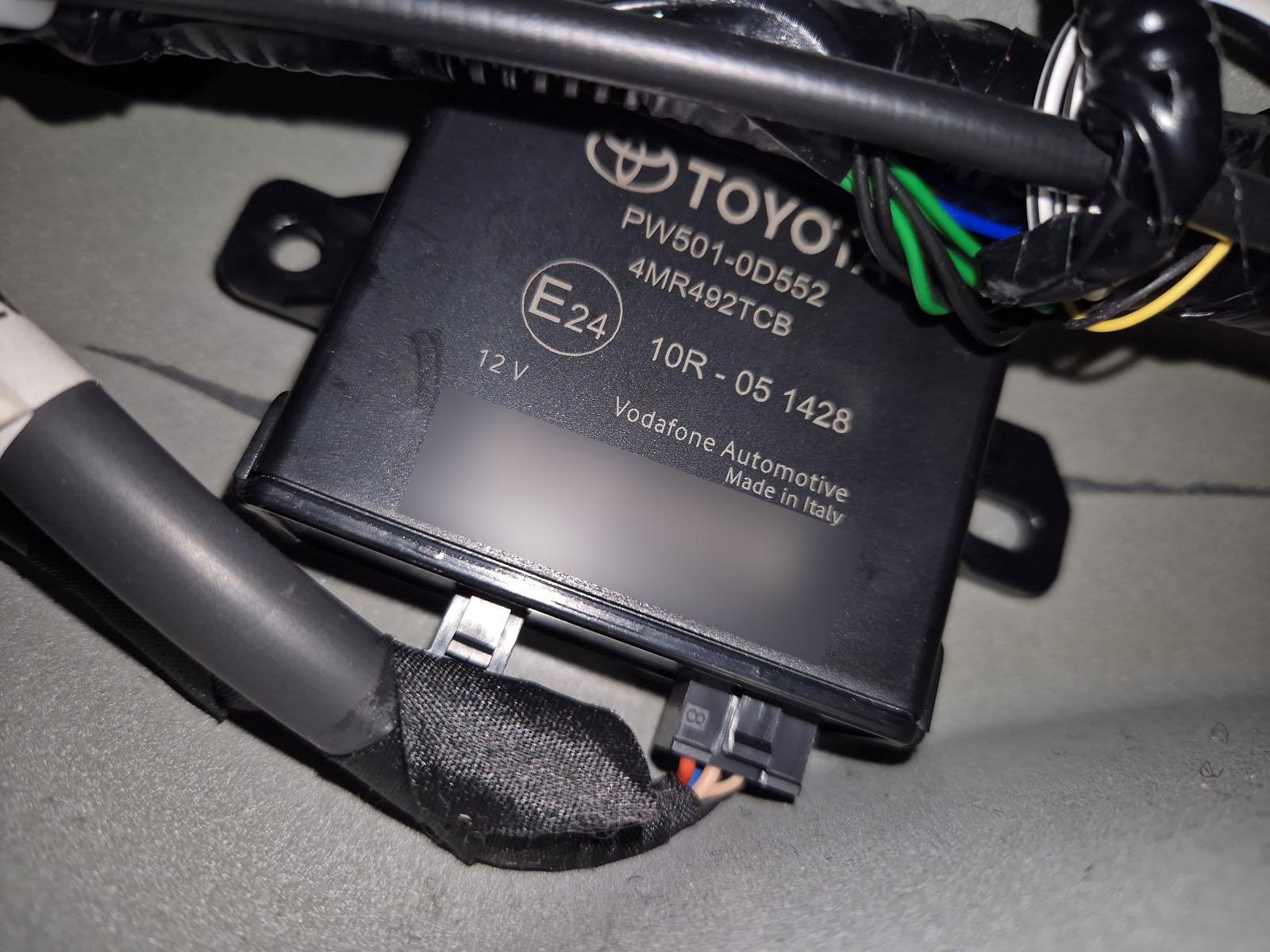

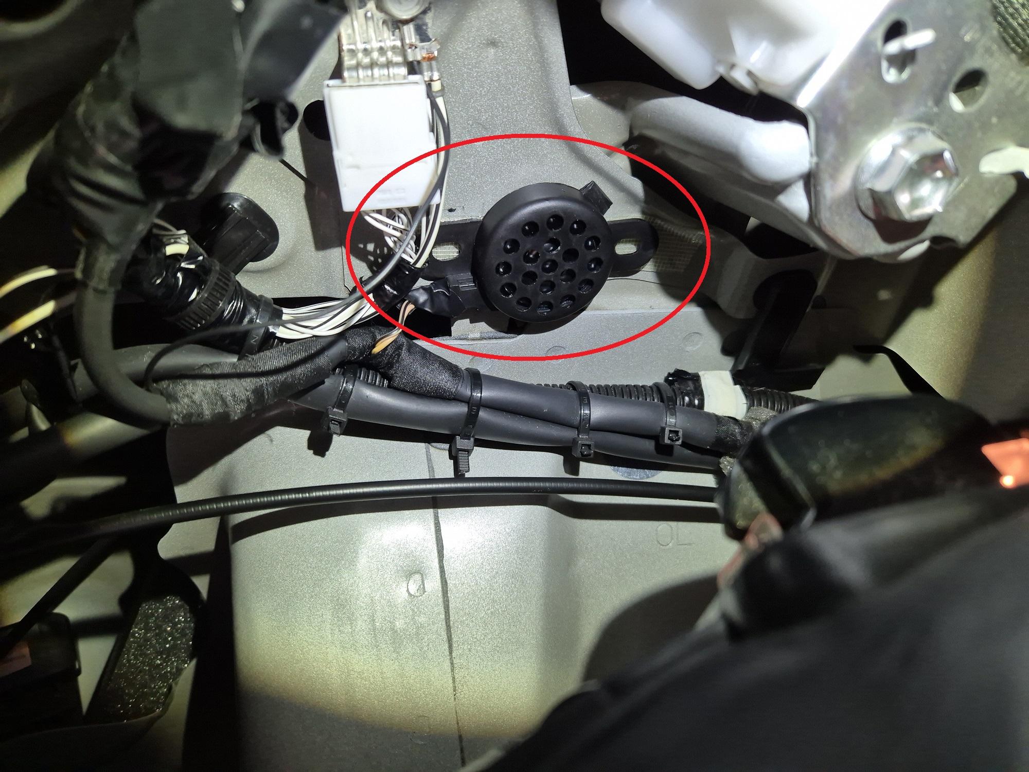

Find the parking sensor module and check if it's powered by the reverse light. If yes, check the buzzer. You can also ask someone to gently touch the parking sensor when they should be working (reverse light on), very light vibrations should be felt. If that happens, I'd blame the buzzer

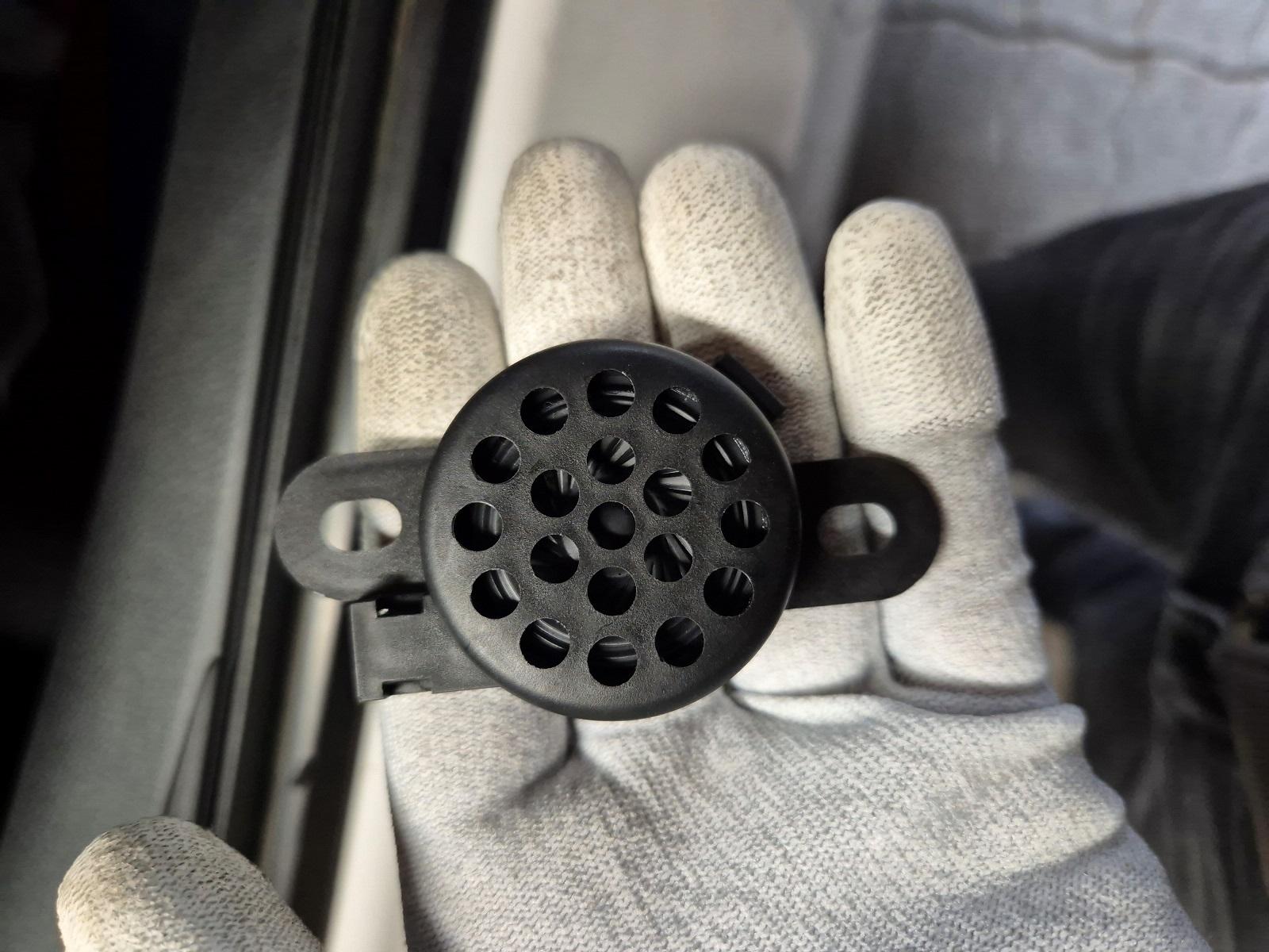

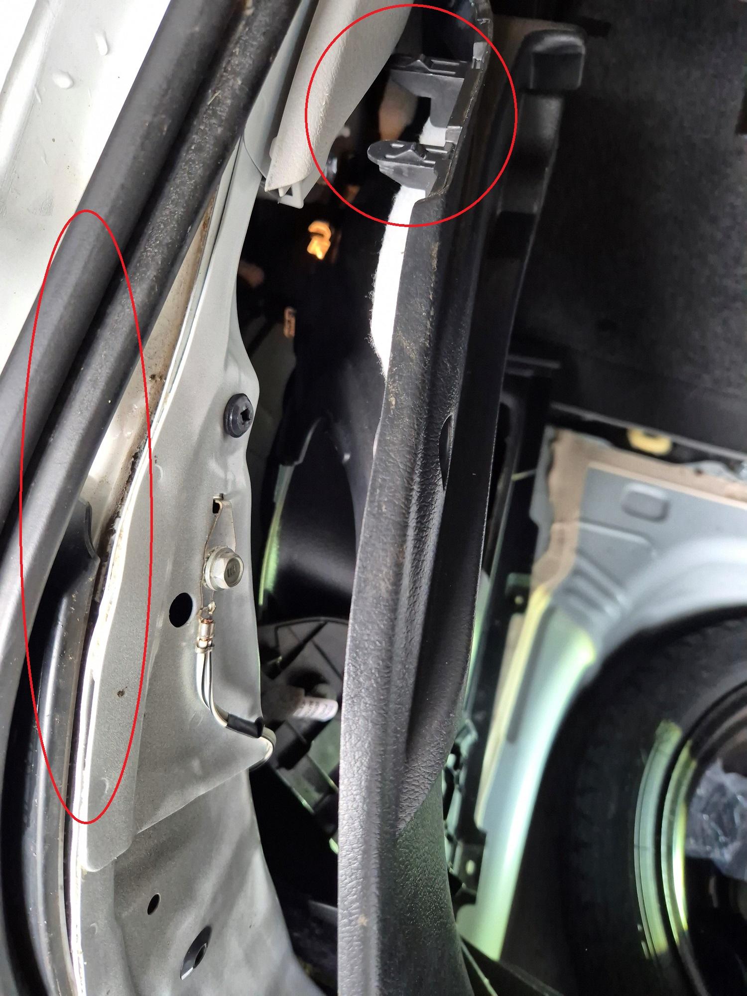

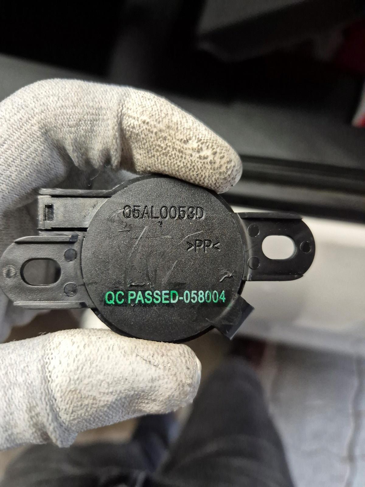

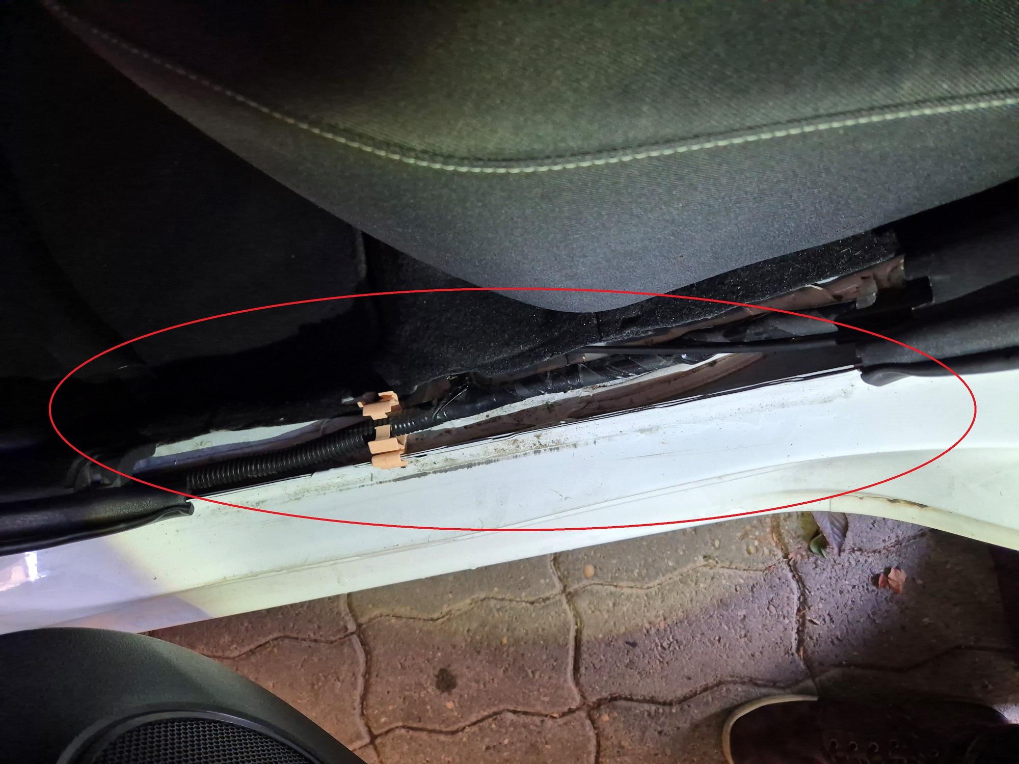

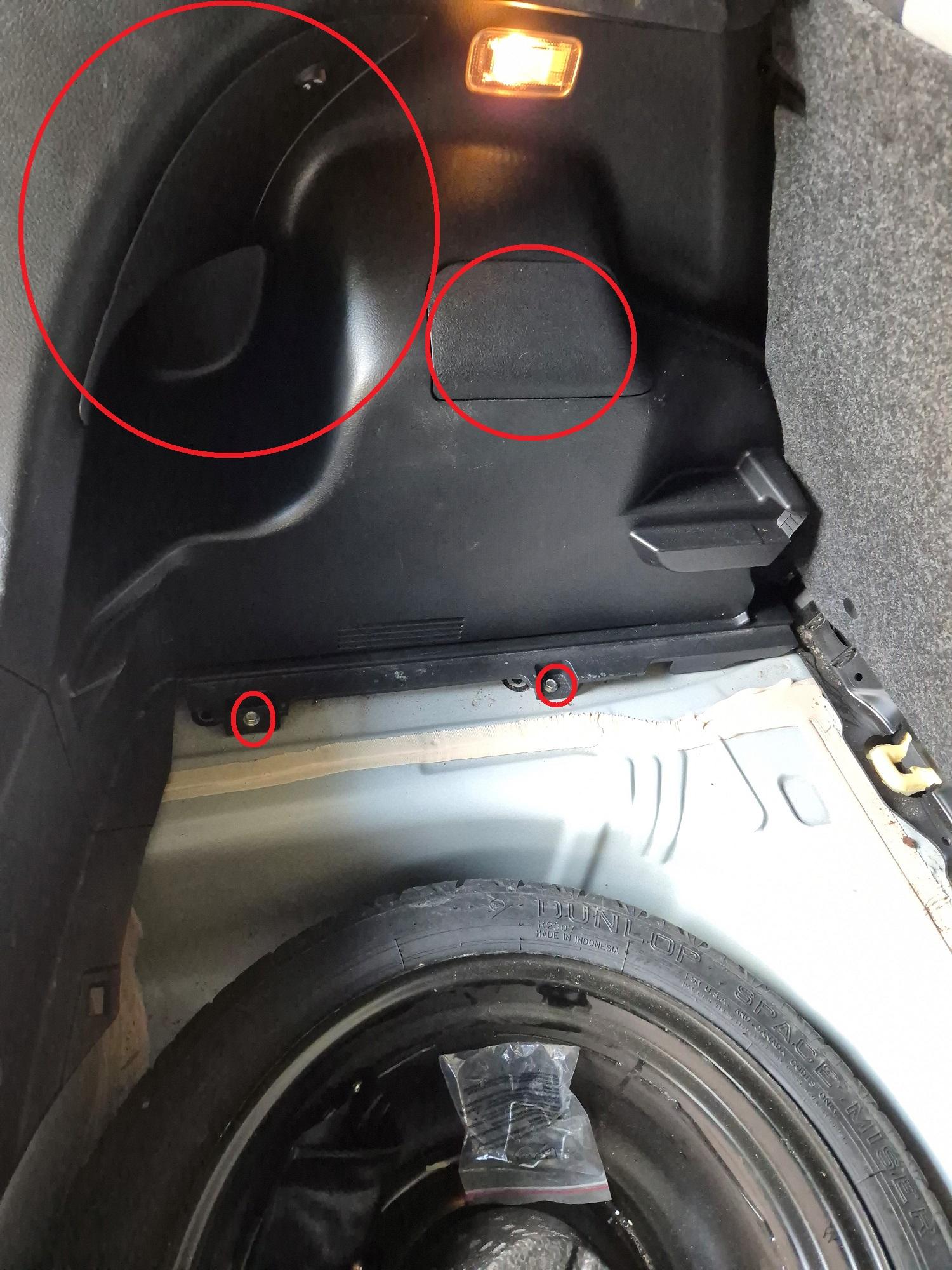

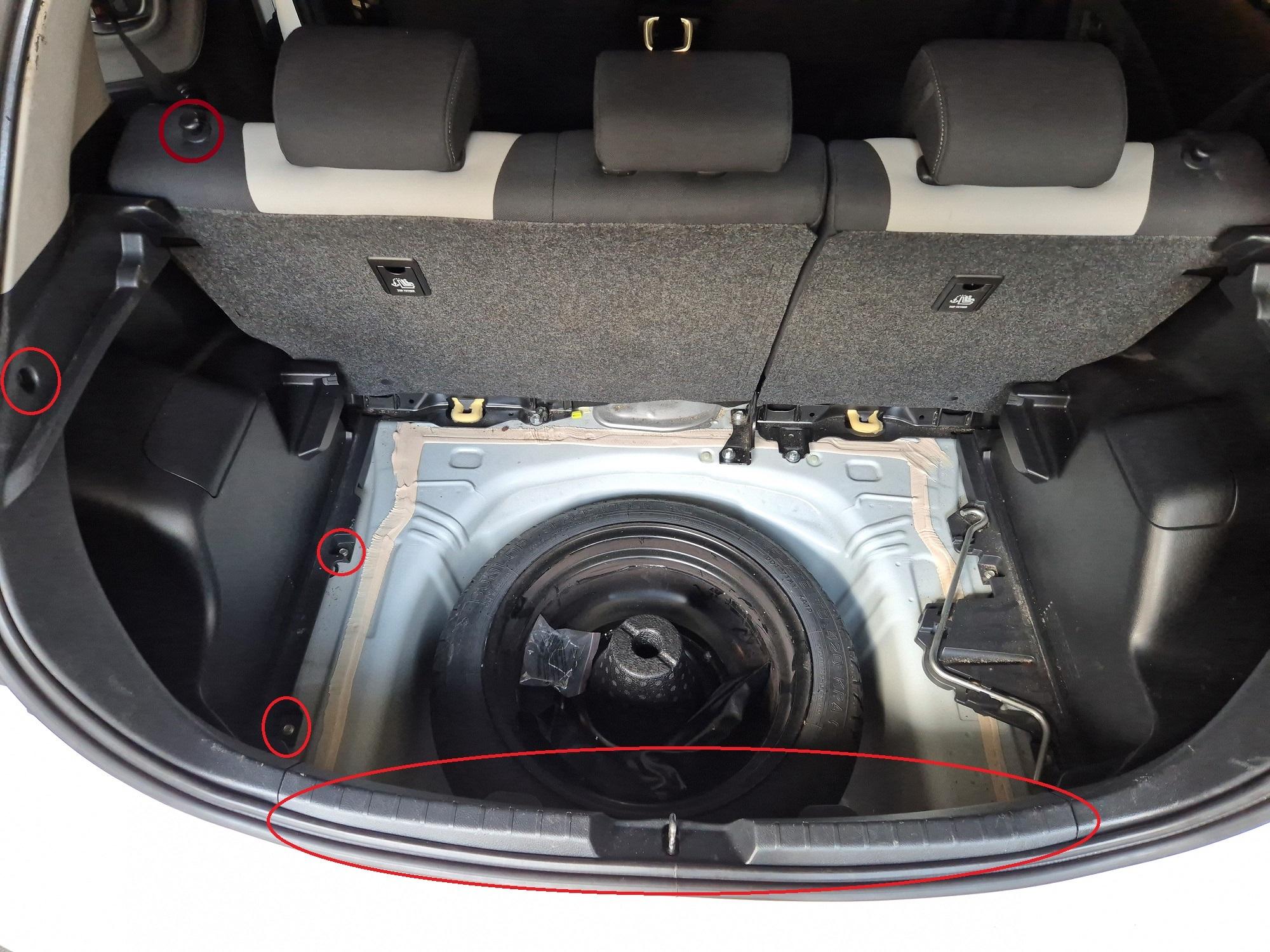

I ended up repairing it thank you.
It was only the speaker that wasn't working.
A few pictures below, hope it helps.
