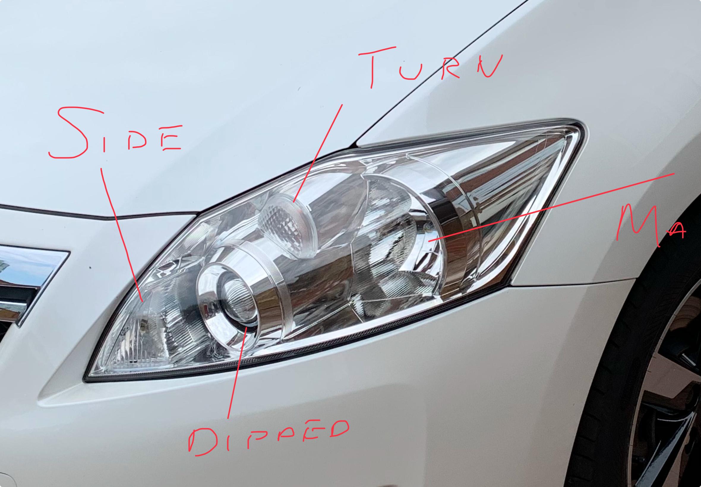

I think it's more the trend of having projector units which may look nice (subjective) and perhaps saves on cost of having 4 reflector units - which when I had cars with them on halogen, no complaints.
Couldn't put up with 8 years, I installed hid after a few months with the projectors.
