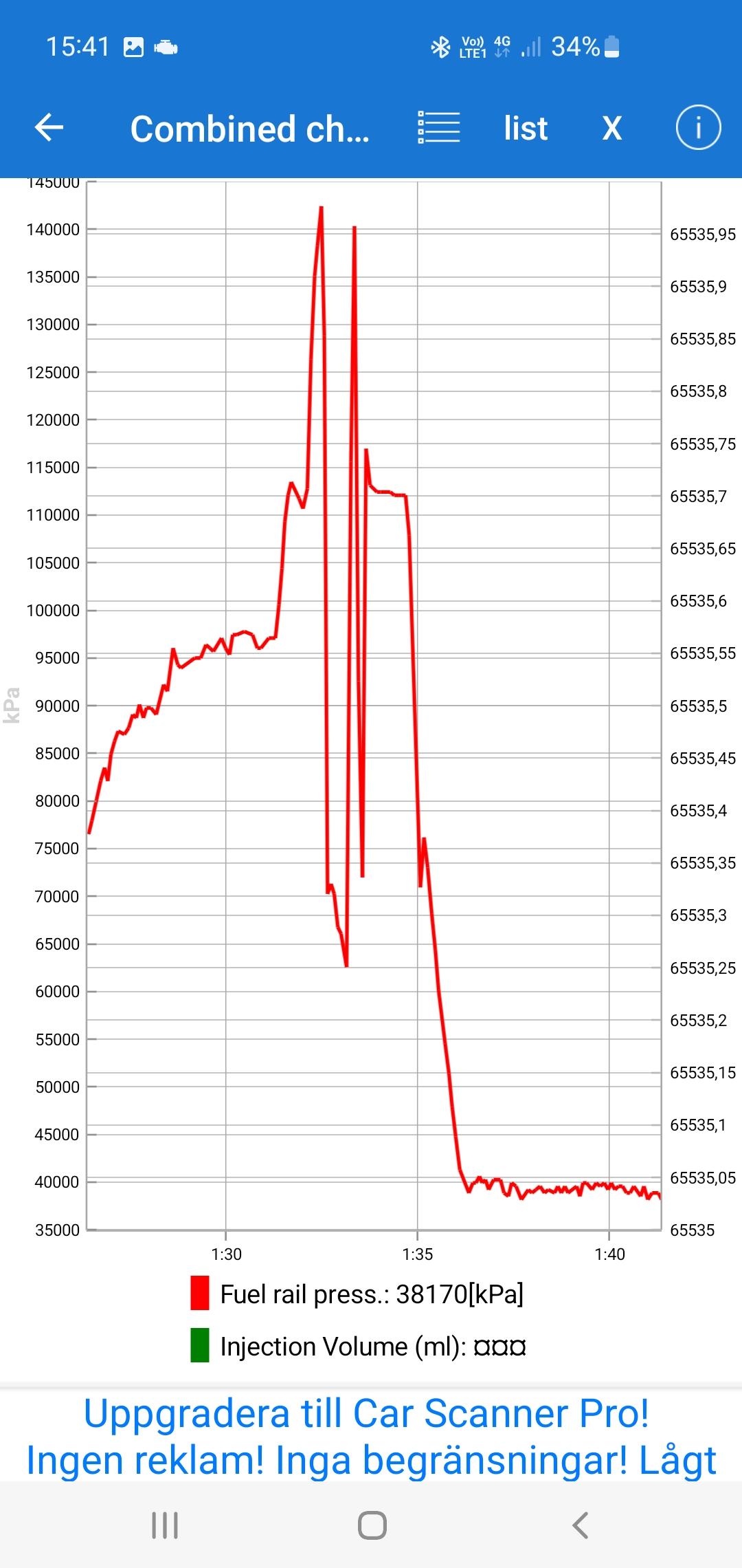

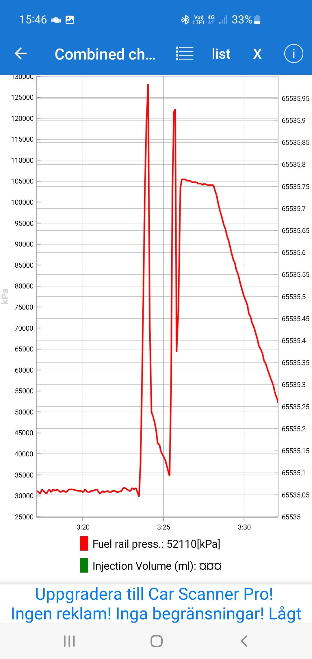

Hi Again.
Did some more tests with the scanner connected. The unit is kPA.
Rail pressure idle 31000
If I rev the engine slowly I need higher rpm before the error occurs. But is it possible to have this high pressure?
More than 145000 kPA,the dip just after the peak is when the the error occurs.
If I rev the engine more rapidly the error occurs on much lower rpm. The same dip though.

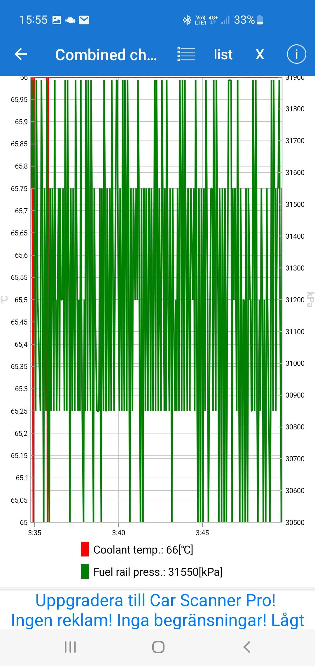

Hi again.
I think I mixed up the pressure units. 31000kPa isn't that  much?
What will a correct pressure be?
And how much will it change with increasing rpm?
