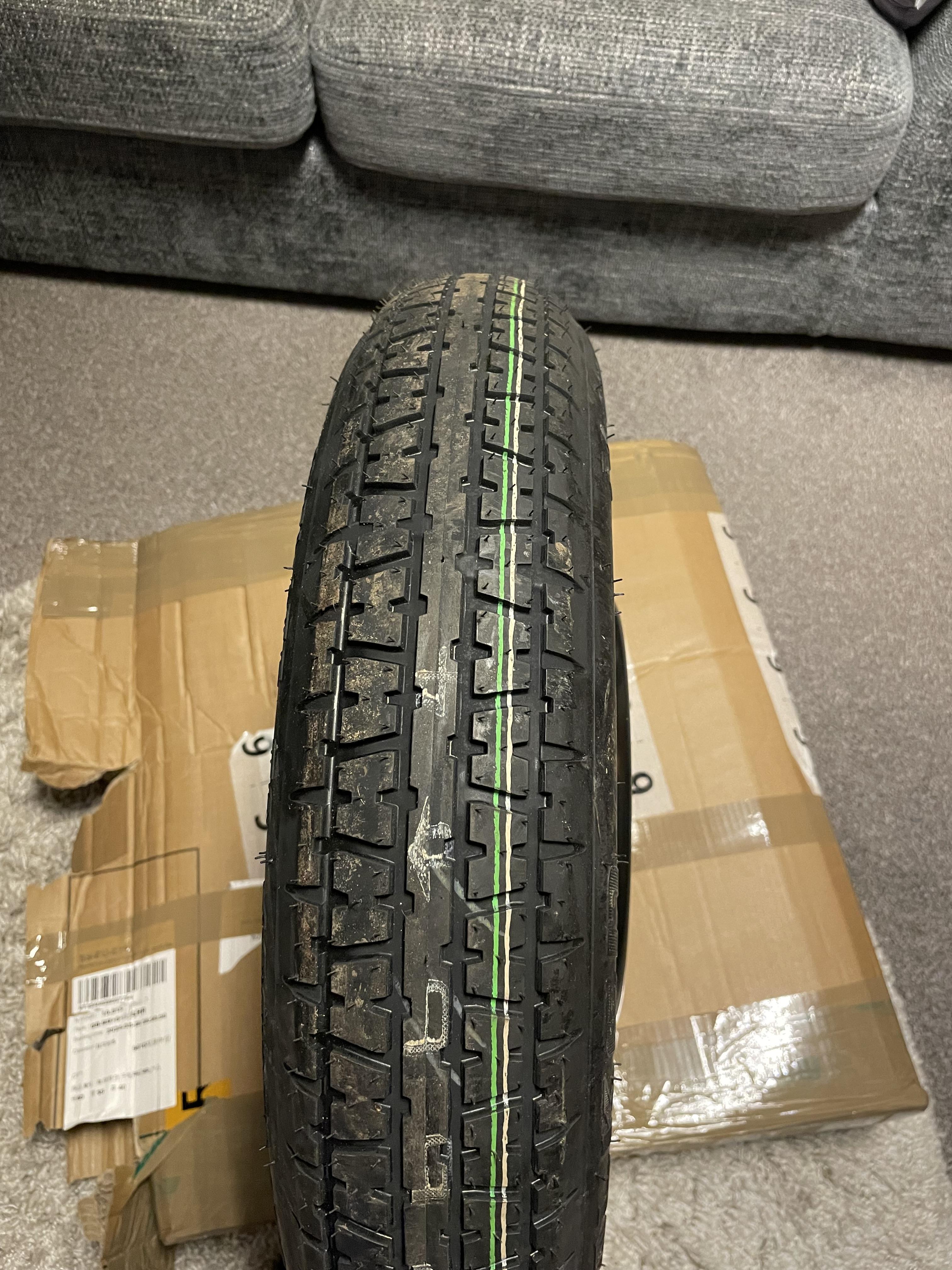

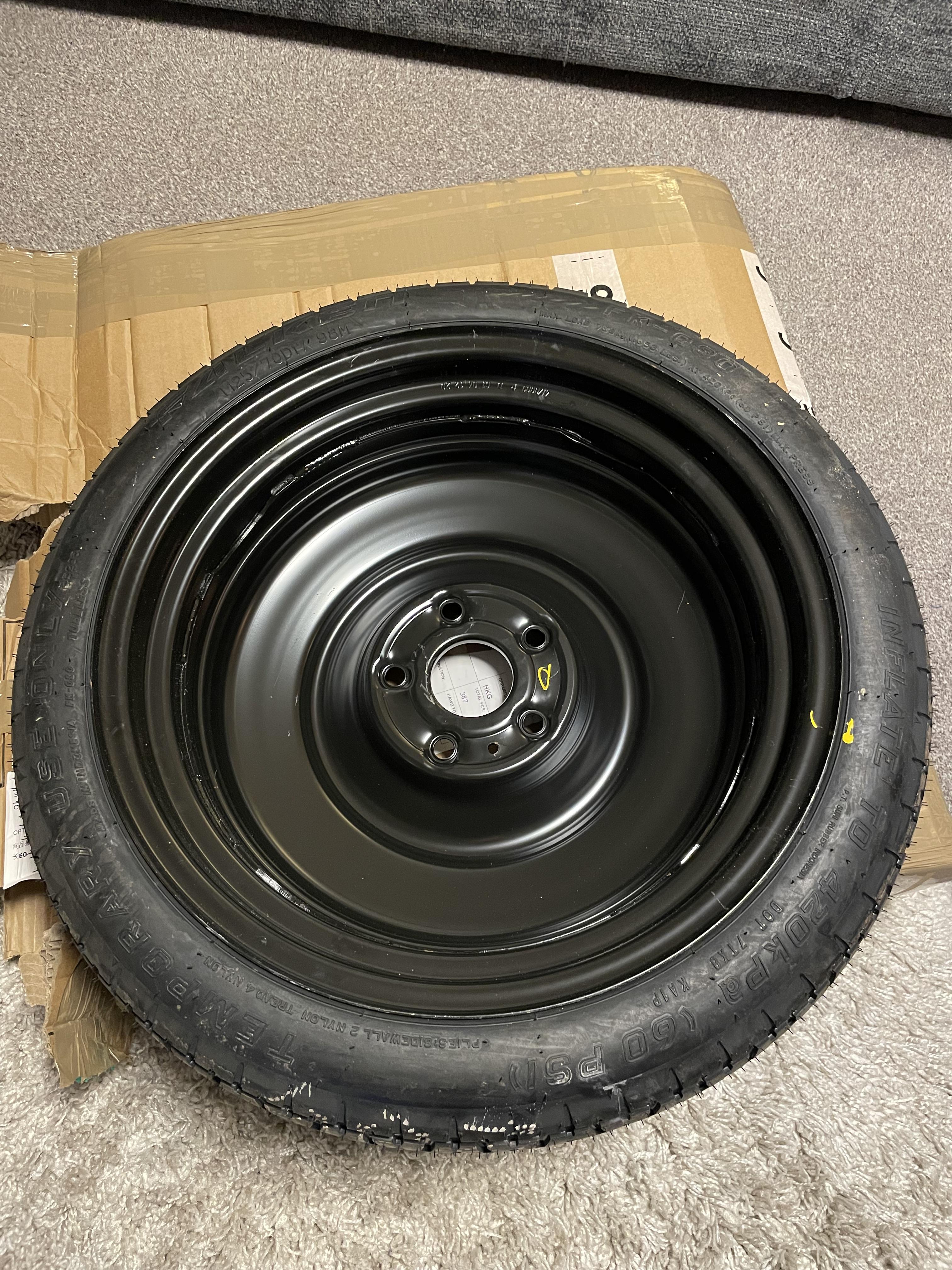

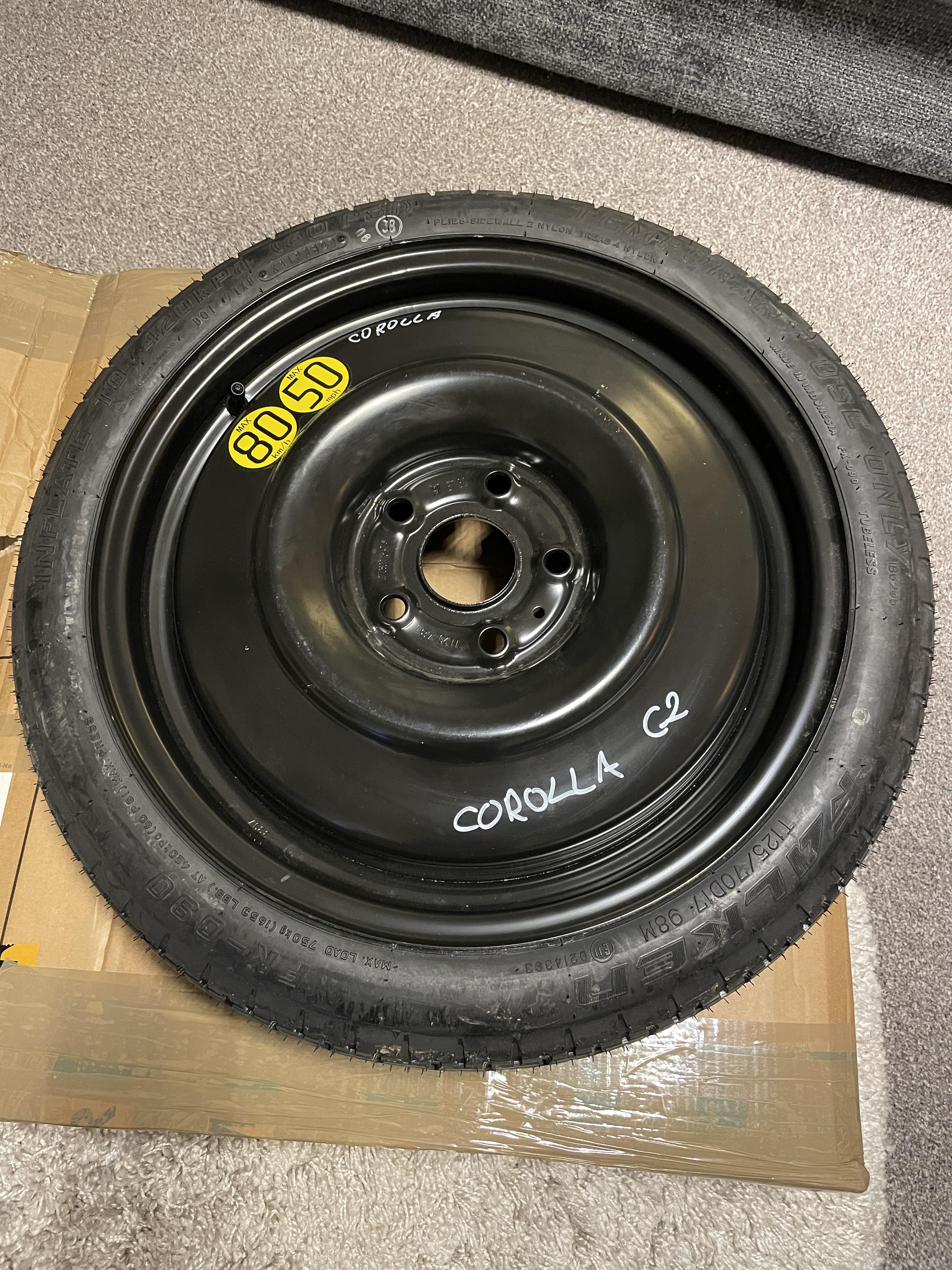

I just got a space saver off eBay for £60 delivered… very happy with it
Ordered the jack and handle from Toyota direct for £27 which is getting delivered today as well
A new space saver alone would be £135 on its own, so I’ve saved a fair bit.
IMG_1026.thumb.jpeg.1f33dc7658b1b8056584de1bf3f6a664.jpegIMG_1027.thumb.jpeg.939ee65edd1f93c31be54e736148f56e.jpegIMG_1028.thumb.jpeg.c40e20a41432e6edb69391b883267d64.jpeg
Not bothered about the trim as I have lots of my bits and pieces to fit inside and around the wheel when it’s in the well
Got it because I wasn’t comfortable driving around without a physical spare, especially on my 550 mile round trips from Sheffield to Edinburgh
