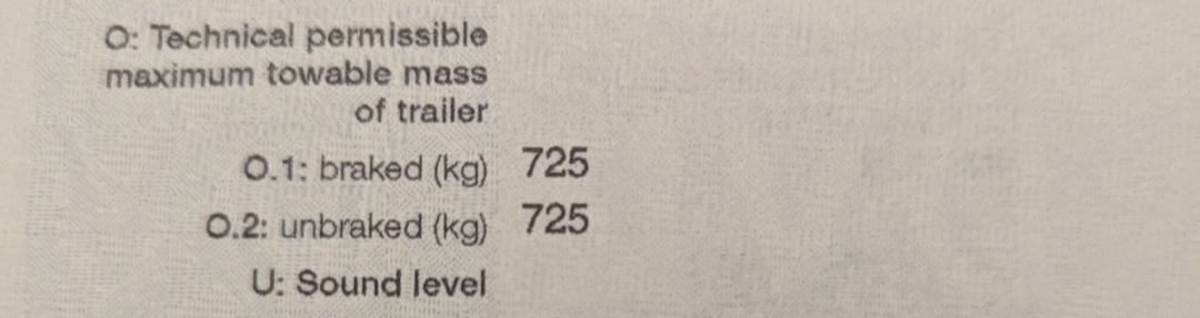

Just looked at my V5C & it's 725 KG

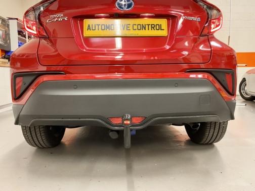

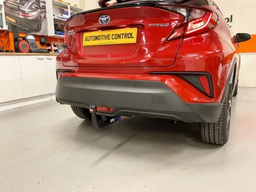

Has anybody got a photo of a MK1 C-HR with a towbar fitted, I'm tempted to get one fitted but would hope it doesn't show that much on the back end.
