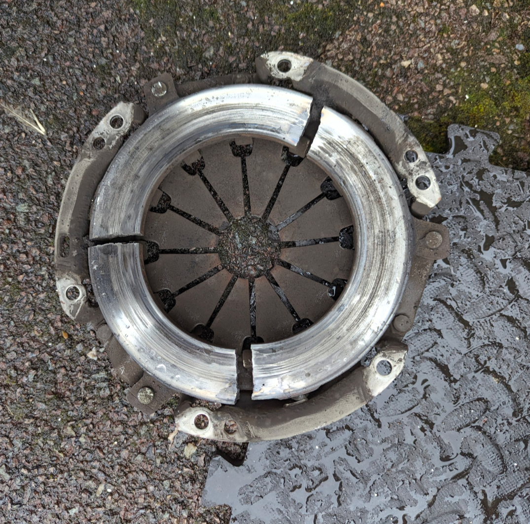

The clutch can suddenly fail...
This was ours in feb.
Blimey what caused that!? :eek:

It was the original clutch, it went after 148,000 miles or so.
The vibration is no longer there but we do anticipate it will come back as mentioned in many other posts on here after the clutch has bedded in.
