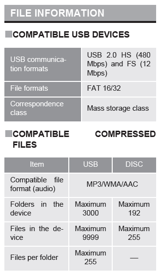

The information you are looking for is one pages 73 - 75 of your media system manual. Specifically:
Thank you - I had not found this page.
The problem remains that I am nowhere near these upper limits when the indexing gets corrupt.  So I wonder if the unit itself is being the problem.
