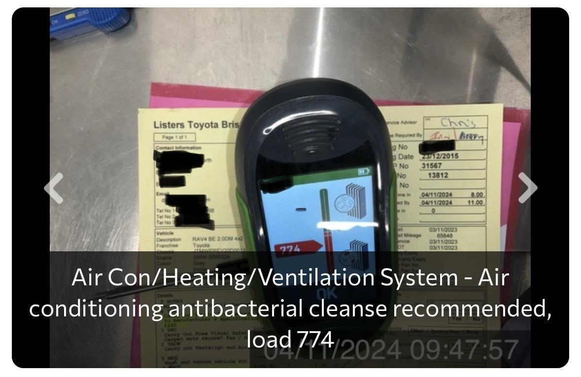

following a service the dealer said we had high bacterial count in the aircon and recommended a £99 cleanse.

Its like the service dept's have a new toy to measure 'air quality' as they quoted some numbers at me to make it sound bad then wanted £200, that is never happening!

They did admit it was a new device. They even took a photo which didn’t help their cause as I couldn’t see how it worked!
mine was apparently 714.
