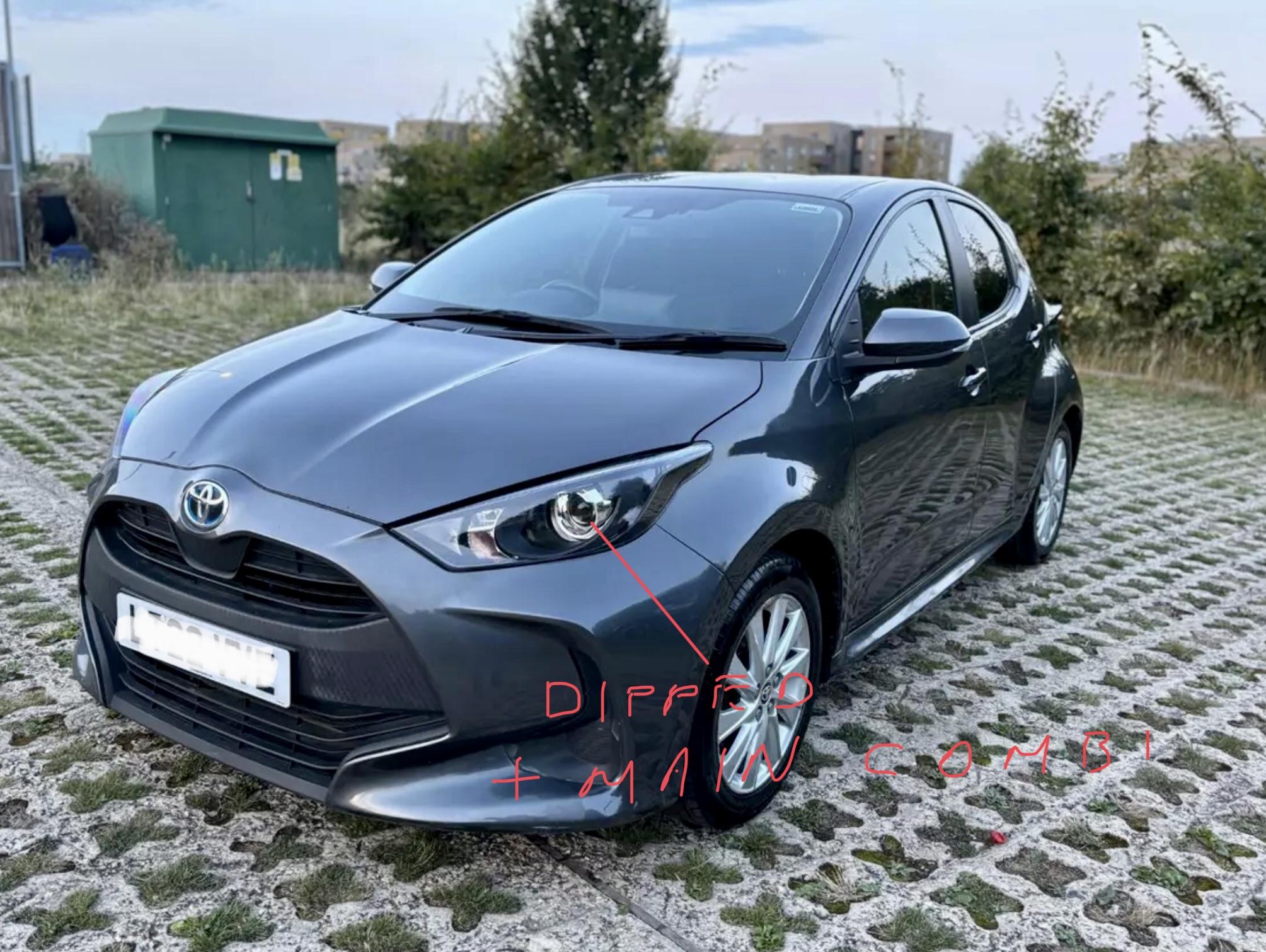

The problem is the light projector that uses a mechanical adapter to switch between dipped and main beams. This reduces light output by as much as 50%, so you have a reduced light performance in a brand new car in comparison to a 20 years old car. These are the lights in Yaris, Yaris cross, Auris and probably other models entry level trims.

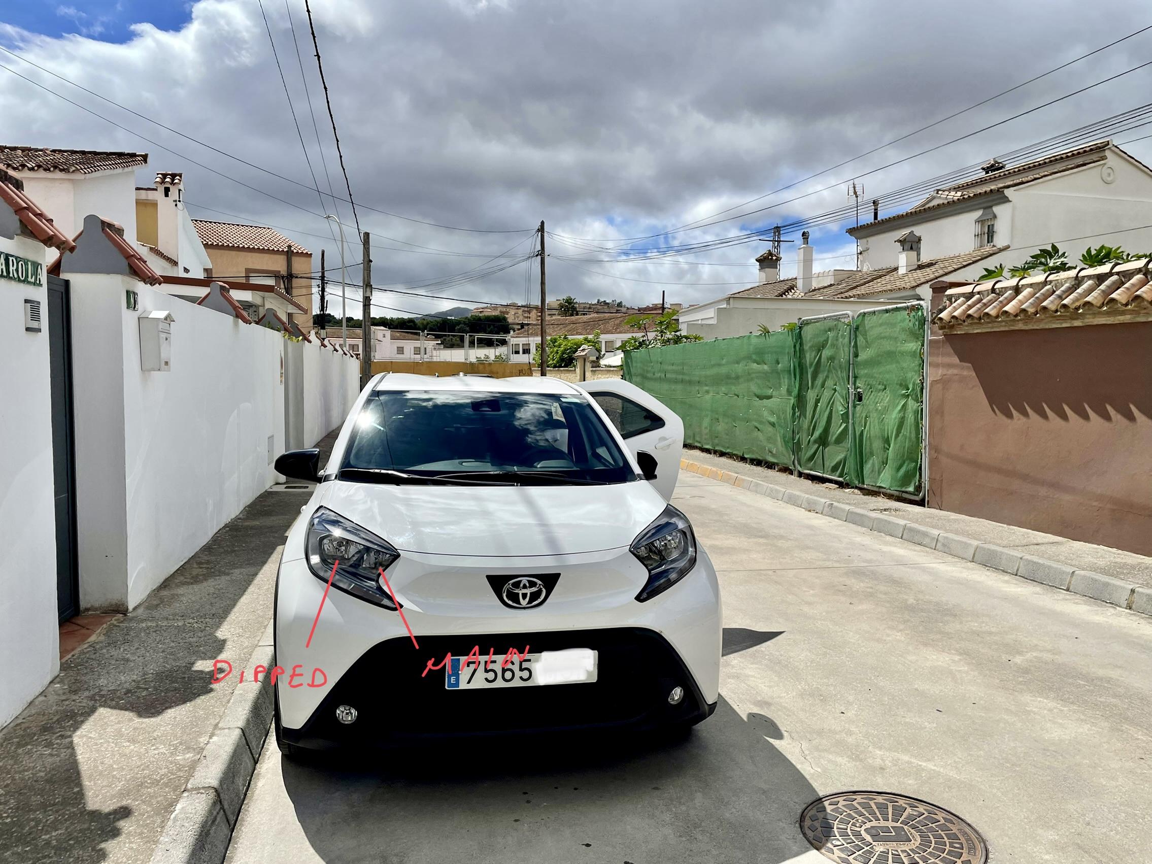

Aygo X uses reflector type halogen bulbs lights and has two separate sections fitted with two independent bulbs, one for dipped, one for main beams. The lights although not as bright as these led they provide a good light ahead and on the side and in any road conditions.
Here the difference better Aygo x pure lights and Yaris icon.
Aygo has great lights where Yaris really poor.
