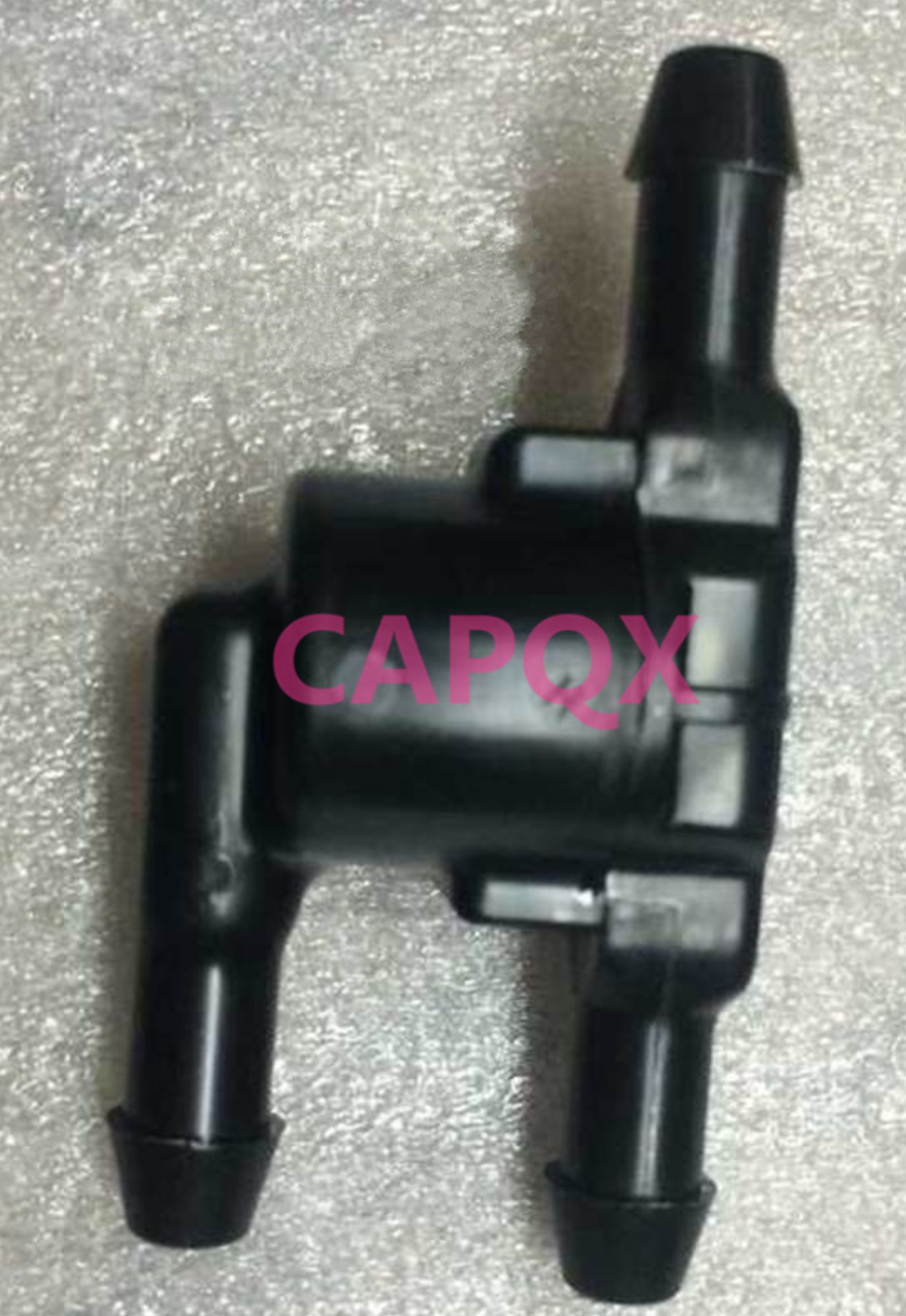

Not sure if the yaris have the same sort of system but perhaps a look under the hood will tell you. It was where the washer pipe came from the pump and then split into two and went to the washers. It was the little plastic thing that split it and this was actually a valve and split the flow equally in half. But our valve was not splitting it correctly and was loosing power so would only go halfway up the window. It was slightly blocked so never allowed the full pressure. When I mentioned it to my local mechanic they said it will be the splitter valve and it only cost something like £1.50.

I tried using a pin in the ceramic nozzles on our Toyota iQ. Not a good idea; it damaged one of the nozzles (they’re quite friable) and made things worse. Replaced the splitter but no difference. Replaced the nozzles and bingo; that made all the difference. Try the splitter first as cheap and a no-brainer; if no joy replace the nozzles (around £15 each).

I had the same problem. Main dealer said it was the non return valve sticking. Replaced it and solved the issue.
