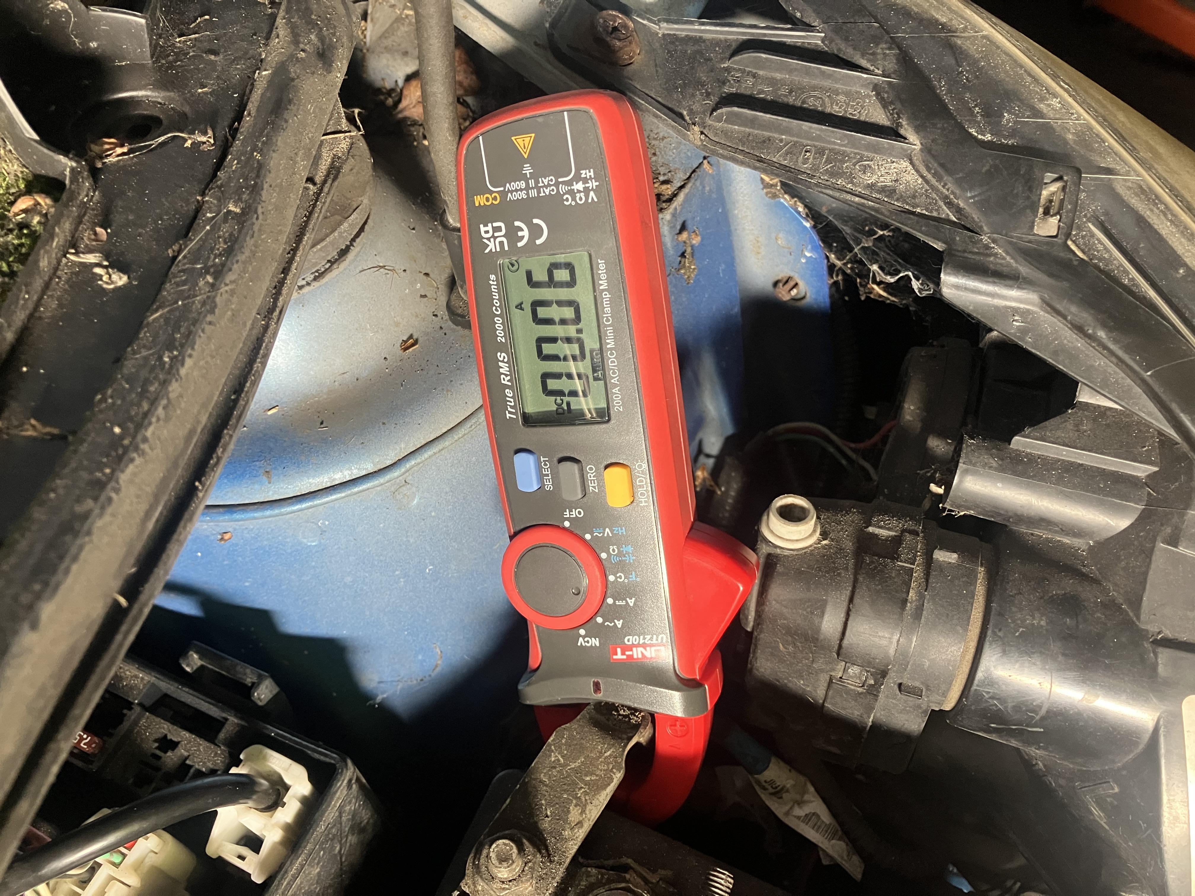

It pulls 0.08-0.11 with a clamp meter on the Battery terminal.

One further thought I had on on all this is whether the clamp meter was both used correctly and also whether it is a type suitable for low current measurement. That last point is extremely important.
These things work by magnetic fields generated by the current flow in the cable and the potential for very large error is real at such low current.

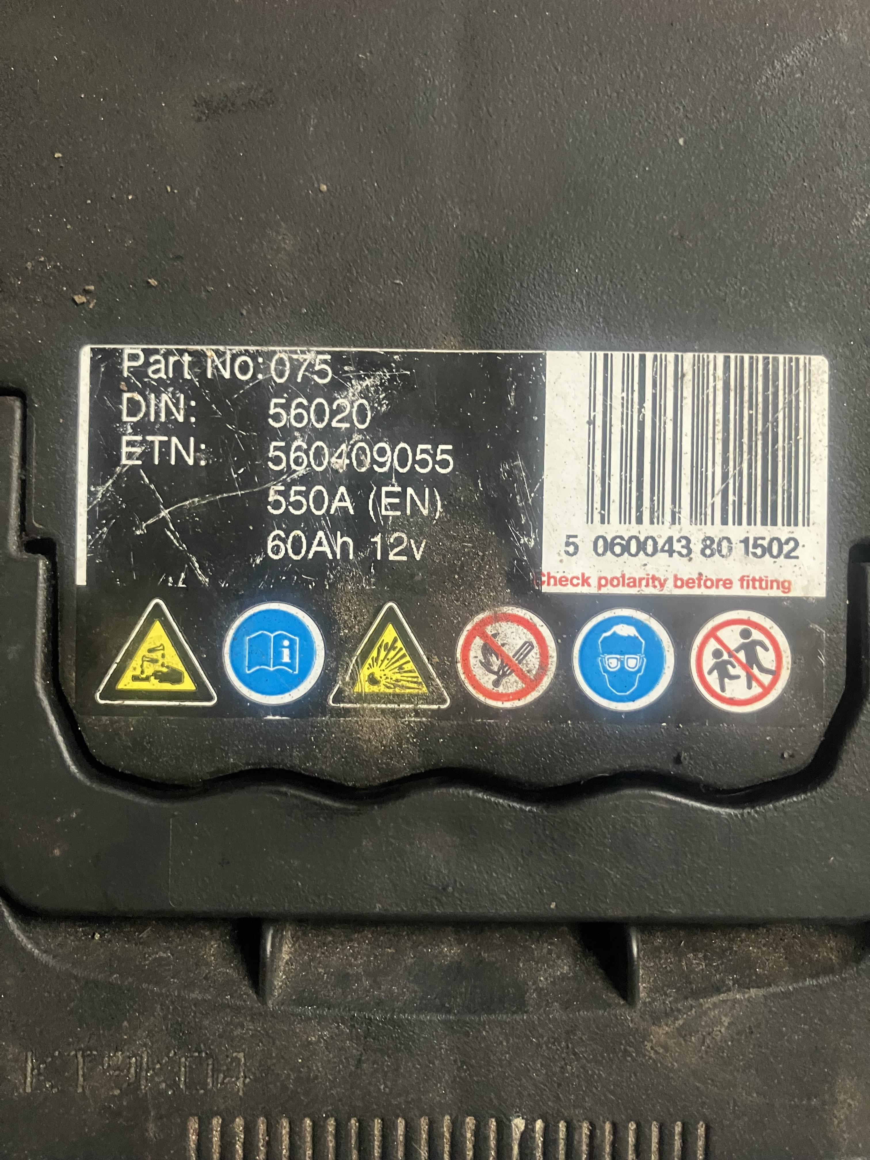

  • Replace Battery with the correct size. Currently has an oversized one

1. It doesn't matter if the Battery is oversized.  In fact, it is recommended to fit a bigger Battery so it provides more power allowance enable you to start the car. My 2012 Aygo comes with a Toyota 063 Battery when I bought it (proper size should be the smaller 079). Even though my battery tester condemn the battery as bad, it still starts the car every time thanks to the extra capacity.

Thanks for the above
This is my set up. Im not that confident with multimeters or electrics of any kind haha.
I noticed that the current drops to 0.06 now and fluctuates up to 0.11 but mostly holds 0.06-0.08 after 10 mins. I sanded the earth straps and re attached them, not sure if that made the difference.

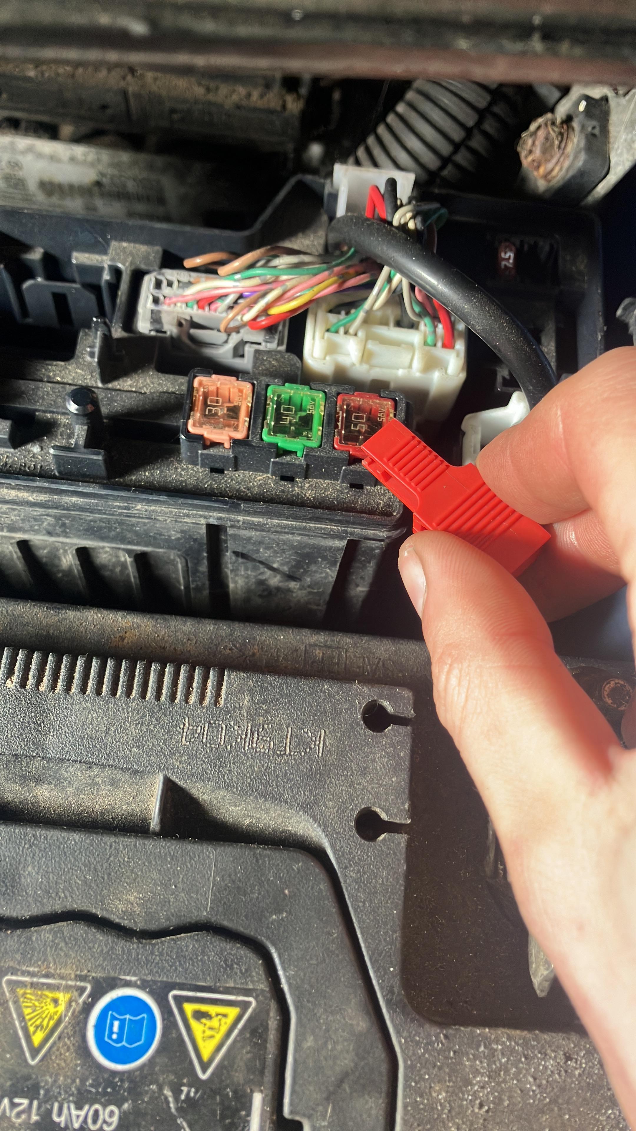

I pulled all the fuses around the steering wheel and the ones beside the Battery in the engine bay one at a time. Disconnected the radio and all the big cables going into the fuse box in the engine bay. No change to the drain, I should note that the large square fuses in the fuse box wouldn’t budge so I left them.

I'm really not sure how accurate a clamp meter is going to be with an irregular rectangular shaped conductor like that. They should be used with normal circular conductors centrally in the jaws.
Almost identical to the Clamp meter that I had.  Mine is UT210E while yours is UT210D.  The one I had was fairly accurate (verified with another multimeter that was connected in series), you just have to zero it out before use.

Thanks for the replies. I done a quick test on my Battery. Put all the lights on and the voltage fell dramatically so, got a new one yesterday and have been monitoring it.
seems fine so far. Reading 0.04 amps using my same test method on the negative terminal. What’s weird tho is the tiny earth that is bolted to the strut is reading like 0.2 amps which I want to ignore haha. Just seems strange that it isn’t different to the terminal reading
