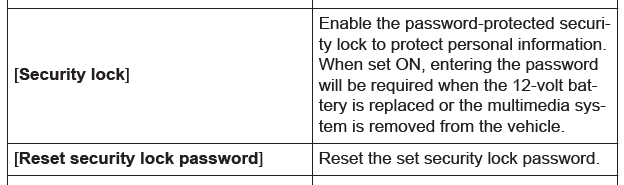

Refer to your Multimedia Manual where under Settings > Info & Security it states:
You may or may be able switch the Securitty lock to Off or Reset it. Otherwise, it may be a trip / call to the dealer ...

Thanks guys. The "Security Lock Password" seems to not let anything be altered on the panel except the code to change it. It seems I will have to go to the Toyota centre tomorrow to ask for there assistance as suggested.

iirc the security lock is only on the touch screen, the dealer can reset it with techstream no issue it should still drive
