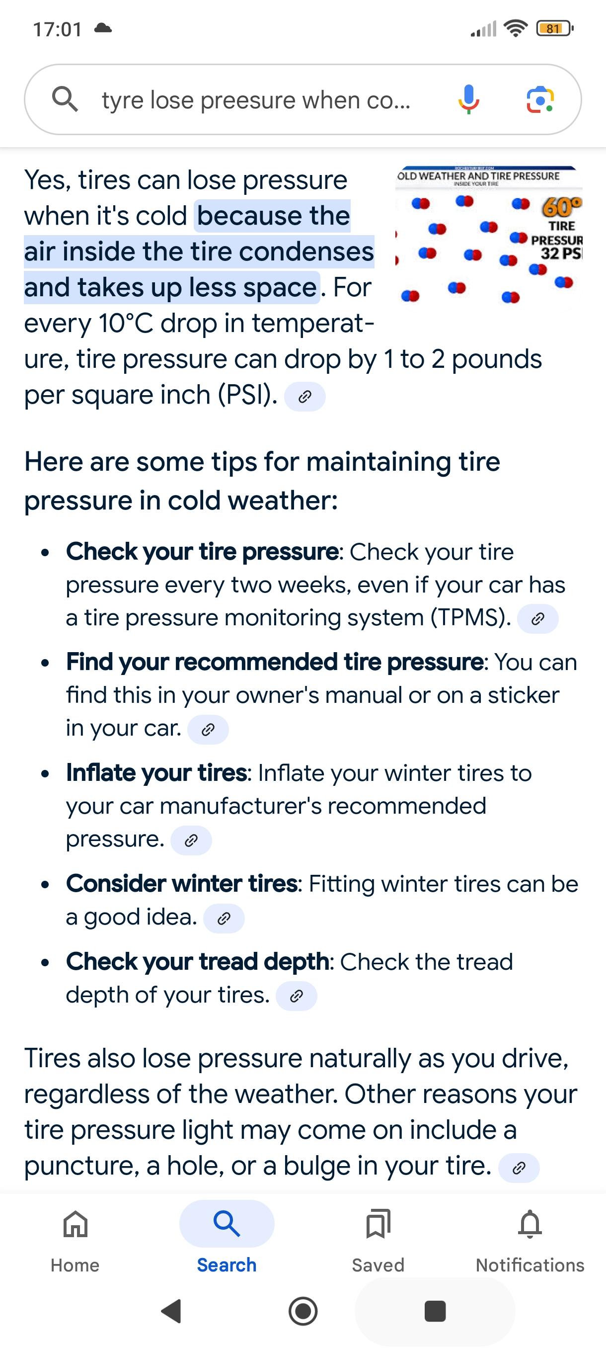

This is not confined to Toyota, every car has this problem when its cold, add 2-3 psi for each tyre. Do some reading on the net and you will understand more.
Screenshot_2024-11-19-17-01-10-899_com.google.android.googlequicksearchbox.thumb.jpg.14ec57effd78a4f3c3cbb9d64dfd86a5.jpg
