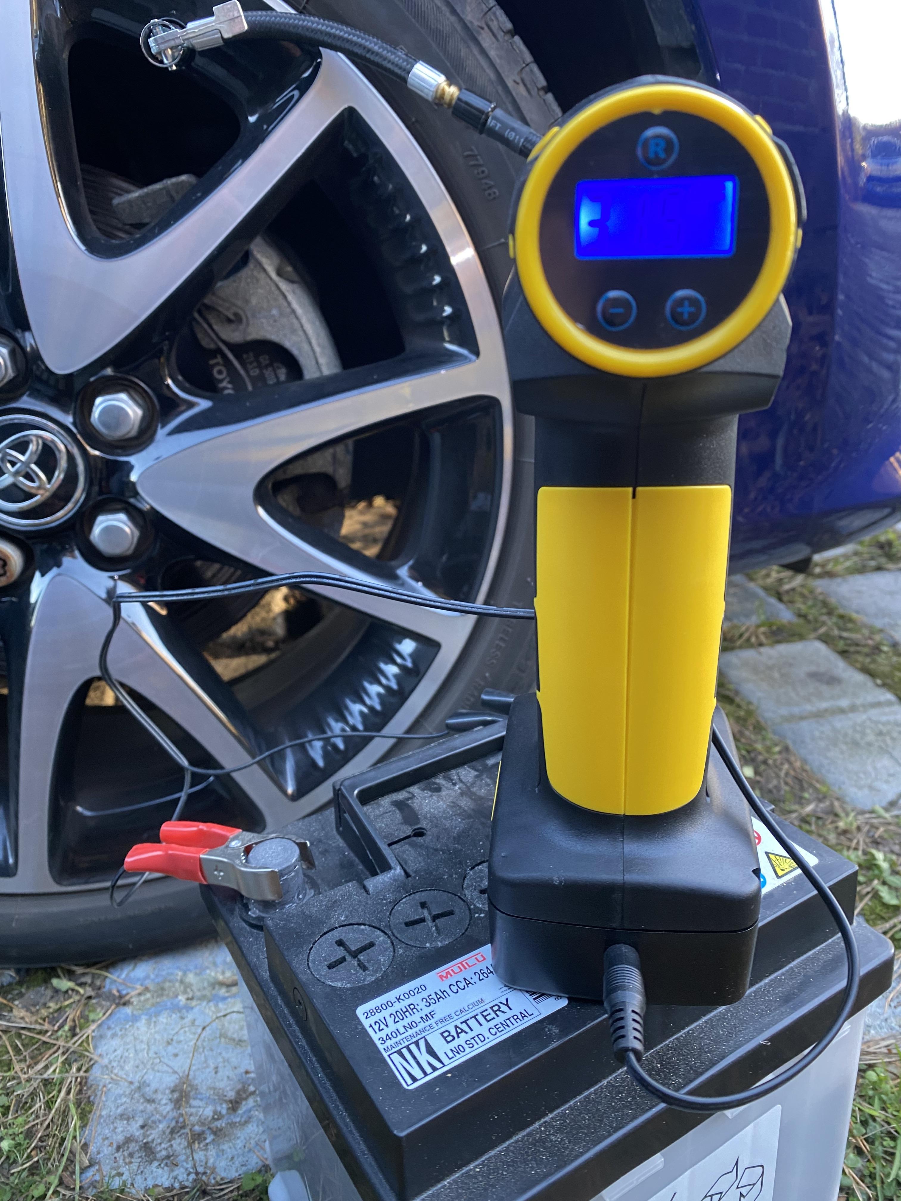

Probbably just down to the climate lower temperatures my car just complained about the two rear wheels yesterday & my tyre inflator packed in so this was my work around 2 rear then the front one adding some air.
Just need to remove the Battery pack is my next step.
