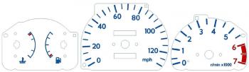

do sr clocks !Removed! wif white dials on dem standard?if so,cud sum 1 PLEASE get me a part num 4 dem r let me no of sum 1 selln a set.fanks!
Clocks? or u mean the dial yeah? i think only the glanza comes with the white ones.
good luck with getting them from toyota. i asked for a price on the sr dial's (mine doesn't have a rev counter) an they quoted me £120 + extra for getting the mileage changed!!!
yeah! good one!! :rolleyes:
i think shelly's right only the glanza V and S come with white dials.
on that note, is anyone getting rid of a set of sr dial's for a realistic price?
Rich.
look for paseo dials there the same but come in white
Cheeky rick had some he was gunna sell me but i dint bother as i thought they wud look abit tacky with red lights in
So see him
Cheeky_rick
look on skewer.co.uk, i got him to make mine, got a pic if u wanna see it
yer pls m8,how wa they?
mate theyr really good, think they worked out to £75
mine doesnt have a rev counter,wantd 2 change all da dials.i seen a glanza wif trd white dials,class.does anyone know ow i can change my dash lights frm green 2 blue??
well mate the ones i got from skewer, hav filters n u just take the green covers off the original bulbs

here you are guys
they wud look pretty shockin tho cos the orignal toyota ones are kinda dish shaped as they have a ridge kinda bit round the edge (its hard to explain but if uve seen em u will no) an with out that you will see too much light an stuff in the back ground if u get me :S
