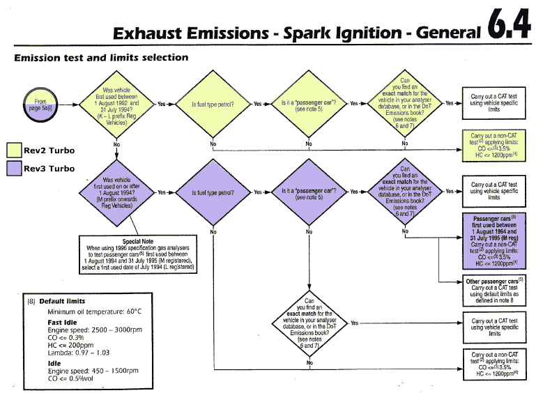

Posted (edited)
Thought I'd post this chart with MOT guidlines on it.
(courtesy of jesus ;) )
P.S. i shrunk it right down, but it should still be readable, if not i'll post a larger version on...
-Z
Edited by ZeroBlade
(courtesy of Bibbs)
-Z
Bibbs getting credit for my work???!!! :D ;)
my bad fella, i've got a pap memory, and it's usually bibbs to the rescue with technical things :D
sorry!!!!
-Z
