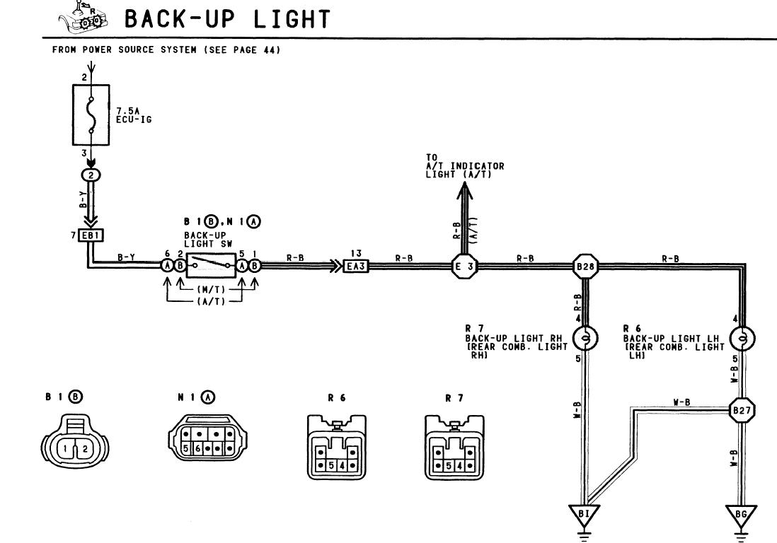

Where is the fuse located for the reverse lights? :wacko:
I've got a soddin MOT early tomorrow and now there not working. :ffs:

according to the book its the ECU IG fuse (7.5amp)

wirings not split and shorted is it?

wirring is fine, but if it's shorted then it should of affected the ECU IG loom aswell.
wouldnt it? :wacko:
hmmm yeah ok it will have blow it
may have just a bad earth though? maybe, possibly?
wheres the reverse light switch??
is it on the gearbox?
check if thats duff?
I think it's on the gaiter, but thats only a guess

It's on top of the gearbox under where your air filter is. :thumbsup:
