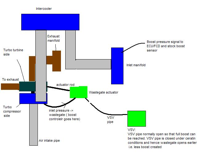

Yeps the boost controller does the same thing but only to the wastegate actuator, i.e. the actuator sees a lower pressure than what is actually in the intercooler pipes and inlet manifold. The boost pressure sensor readings come from the inlet manifold so will always read the actual boost pressure, hence why a FCD is needed.
You can get vacuum in because under low load/idle conditions the engine cyldinders are sucking air all the way from the intake into the chambers on their downwords stroke. Also the exhaust gas pressure and temperatures are not high enough for the turbine side to drive the compressor side fast enough for it to create positive pressure, its basically freewheeling at this point and not creating any useful work. The boost pressure sensor and wastegate actuator are all seeing negative (vacuum) pressures at this point
When you put your foot down of course the turbine side spins up and the compressor spins fast enough to increase the pressure in the system, this is when we get positive boost :hokus-pokus:
This site has more information, its based on the 3SGTE for celicas but everything works the same way, my little diagram below is the same system but as viewed in an mr2 engine bay

Your just a fountain of knowledge Deus ! And a little diagram too.. Who are you trying to impress as there are no girls on this forum ! :huh:
lol just trying to help out mate, I was in exactly the same position as you just over a year ago so its my payback for the help people gave me back then :thumbsup:
