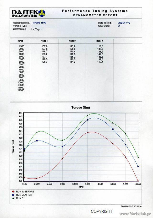

Because I like to talk with figures and not just with words;This is the dynometer chart,from a yaris Tsport, member of the Greek Yaris Club.
The red line represents the torque with a correctly fitted induction kit,and exhaust muffler.
The blue line represents the torque including all above plus Dastek Unichip plus changes in the exhaust diameter (which proved later to be wrong-too large diameter)
The green line represents the torque with all the above but with correct diameter of exhaust pipes and a race cat fitted.The exhaust manifold is the stock one on this car.
The dastek unichip as you can see in the graph gives you at least +2 kgm of torque at 2000 rpm. Furtherore you have 93% of your torque available at 2000 rpm!
What does diesel say to that?You have to note that with diesel the availabe torque is there for only a small margin and you need to change gears all the time plus you are short of power at 5000 rpm.With Tsport you can go up to 6700 rpm.
This graph cannot be used outside the TOC.Legal action will be taken against anyone breaking this rule.All rights reserved.
I must say, that is an impressive amount of torque at the low end. Gone from hardly anything to 93%! Amazing.
hmm the graph doesnt start from 0 on the y axis. it starts from around 100.
Just a quick note guys and girls.
The torque on the graph is the real torque of the engine.You should add on that number, the losses which are about 15 to 18%. The number you get, you can then compare it to the torque given by Toyota.
But anyway,since in all three runs we compare the same quantity, it is easily seen that unichip helps.

Wow. I've never heard of a chip that produces significant results in a non-turbo car.
That's beyond amazing if I'm reading those dynocharts right. Am I correct understanding that with nothing more than this unichip, you got 14-16 more bhp?
This goes against a lot of what I understand honestly. I'm a still a little suspicious, no offense.
Chips increase fuel and boost in a turbo car to give good results, but there is very little that can be changed in a naturally aspirated cars parameters. Fuel/air ratio has to remain the same for emissions and smooth running. The only thing I can imagine it doing its advancing ignition timing, which will only work if you run high octane fuel and it's hard on the engine.
I'm very, very, very curious about how this chip does this exactly.
thats a torque chart.I didnt post the the horsepower chart.
If you read a couple of posts over this you will see what is currently installed on the car.
This car got about 12 extra horsepower.You can see this chart and many other charts from yaris cars,with and without the unichip installed, if you go to the www.yarisclub.gr, to the gallery option,and click on the Dyno day
well you can be as much suspicious as you want.but how about this?we have a 1.3 yaris in the club that is faster than a stock 1.5.that 1.3 has got the gearbox as the tsport,but it doesnt have cams or turbo or nitro.It is just first stage tuned.
well here you are wrong.As I have mentioned previously,toyotas are running very rich.Stoichiometric A/F ratio is not the one that gives you the best power.The best power comes with A/F at around 12:1.
