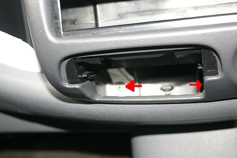

Got my headunit fitted 2day but having problems,Once everything is fitted the bottom of the stereo bit(ashtray ect) keeps popping out! :censor: Any 1 had similer problems?

Ref facia falling out at bottom:
Did you fit the bracket which screws to the back of the coin tray and then screws in behind the ashtray mounting lugs.The 2 legs which mount on the ashtray screws are offset from each other,one is parallel and the other is angled away from you.

the grey outer panel clips on. a gentle but firm push at the top and bottom will help it clip in. careful just incase something is in the way. the how to guides on this forum show you what you need to do.

wat part u mean that keeps fallin off? the surround???? I dont kno much, but i seen quite a few of them been done b4. :huh:
Make sure the black Rav 4 bit sits in the middle of the surround, i noticed that you have to ease the inner bit up at one side then press the surround in quite hard so that it slides underneath it! It will click and the centre part should just sit nicely if it is bolted in right... Regard...
