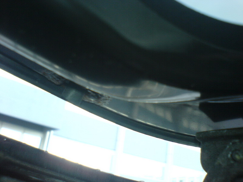

I had this problem also, Toyota replaced the sunroof under warranty when the car was just under three years old, but this rust problem is happening again, although a bit slower (see pic).

So if it's just the frame, could it not be treated with a rust converter and then painted - perhaps rust inhibiting primer followed by appropriate colour paint (black presumably).
[EDIT]Oh, just saw the pic; worse than I'd thought it might be. And I see it's body coloured; could still be treated and then touched up rather than being replaced. Hard to see how they can argue it's not part of the body when it's body colour though - if it had been the black transport mech then I could understand the distinction more easily.[/EDIT]

Mine is glass on an 03 car. The rusted frame is not body coloured, just black painted. It is not visible from the outside when the roof is closed, but the glass screws to it and the rubber seal then fits around the two.
You may be right with 4 screws to remove the glass/frame unit then a few screws to separate the two.
I think eventually the rust would mean that the rubber seal will not stay in place when the sunroof closes.
I will try to identify the part from a workshop manual and price a spare, hoping it is available individually!
If I do fit a new one, its going to have plenty of rust proofing applied!
I don't think the frame unit is available separately, only as a glass/frame assembly, I wish it was though.
Judging by the picture from the parts catalog, that seems to be the case, for both pre-facelift and facelift.
