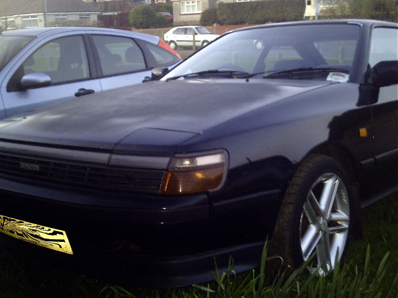

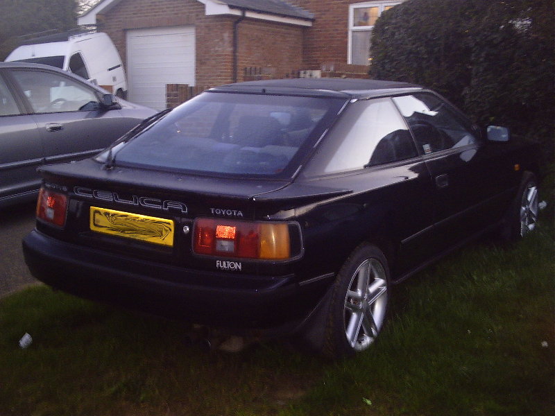

Kewl... Thanks.. Will give them a try... As for buying a newer one???? I'd rather have an older one but this'll do... Nearly bought an 06 Hyundai Coupe the other week.. Sorted it all out and got home.. Sat in mine one last time before breaking it.. Thought bugger that I'm keeping her... I just can't bring myself to sell it.. Too fast for too little... And everybody turns to look at it because they're so rare now...
Proper car mate.
I've always loved the Gen 4.......and from the pics yours looks like a good one.
Have you looked into getting the calipers refurbed? there are plenty of places that can do this for a fraction of the price of new ones.......after all it's taken 8 months to get to this stage so what's another small delay?
