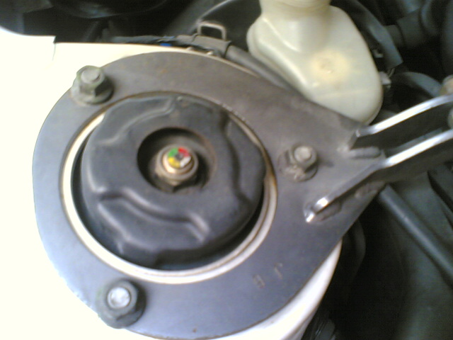

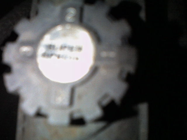

here is a couple of pic's of the adjuster on the front and rear shocks please if you can tell me anything about them i would be truely gratfull

on the front its got numbers but the rear ones dont

I presume it has numbers 1-4 on the front does it? With a number representing a colour? 1 being the softest setting etc. I dunno who else has these, somebody must have. Are there colours on the back too?

1=white 2=yellow 3=green 4=red the rears dont have colours but they may be numberd
So 1 would be the softest setting then and 4 the hardest. I can only guess that yours are setup to be different at the front and back as the celica being ff tends to understeer ( although with real good tyres this is dramatically improved!) rather than oversteer. I suppose if they were set to 1 at the front and 4 at the back then this would cause the problem.

Try backing the rears off. Should be anti clockwise on the adjusters. Hopefully they should have a detent to stop them going back to hardest from the softest setting. If you get my drift (No pun intended) :rolleyes: If the suspension is too firm on the back it will skip out on bumpy corners. As you`ve found out. :lol: Then just wind them up until it feels right.
The fronts need to be firmer to control the understeer. :thumbsup:
It Looks like you have trd rear shocks, are they green? they look similar to the ones I have, cant mind if there 5 or 8 way adjustable.. Those fronts sound like kyb adjustables.

anyway i was actually after finding out how to adjust the front ones as there is only a bolt with numbers on it and no marker to indicate were the number you choose to set to should go

hmm you maybe just need to get a more even balance then, making the front full hard and the back fully soft would make it most neutral, If there are KYB's, which the look like but i'm not sure!! then you just stick a screwdriver in the slot in the very top in the middle of all those numbers and turn...

Ive been out and checked more closely there all set to four the front ones do have a slot in the middle the rears just seem to have that dial with numbers both rears have four to the bottom but there not green there all black and have "super special"writen on the dial,

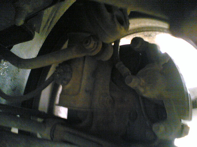

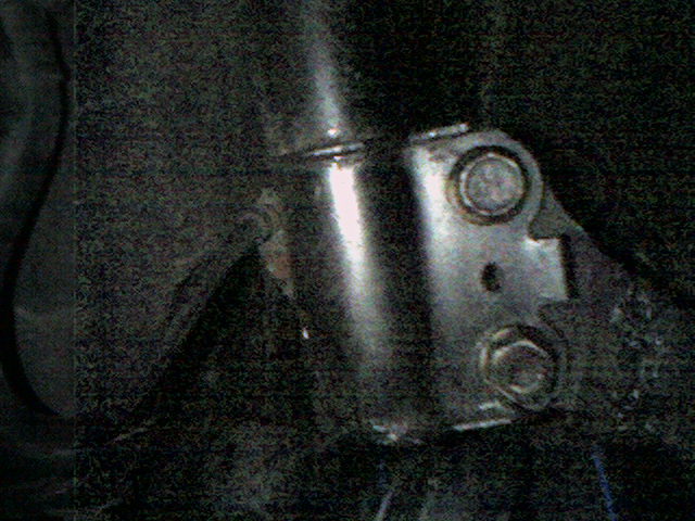

I also added a photo of the front shock were it bolts to the hub...
ill soften the rears should sort me problem out

Going by those pictures those are normal macpherson struts up front, not superstrut, so it looks like you have an SS-2 as the chassis code suggests, at least you wont have the joy of replacing all the links when they wear out.
i set them all up today cars much better ..... if the front ones are macpherson then what are the rear ones is there such a company called super special as it does have that written on the rears or do you think that could just be the model
