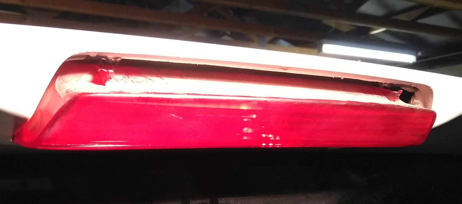

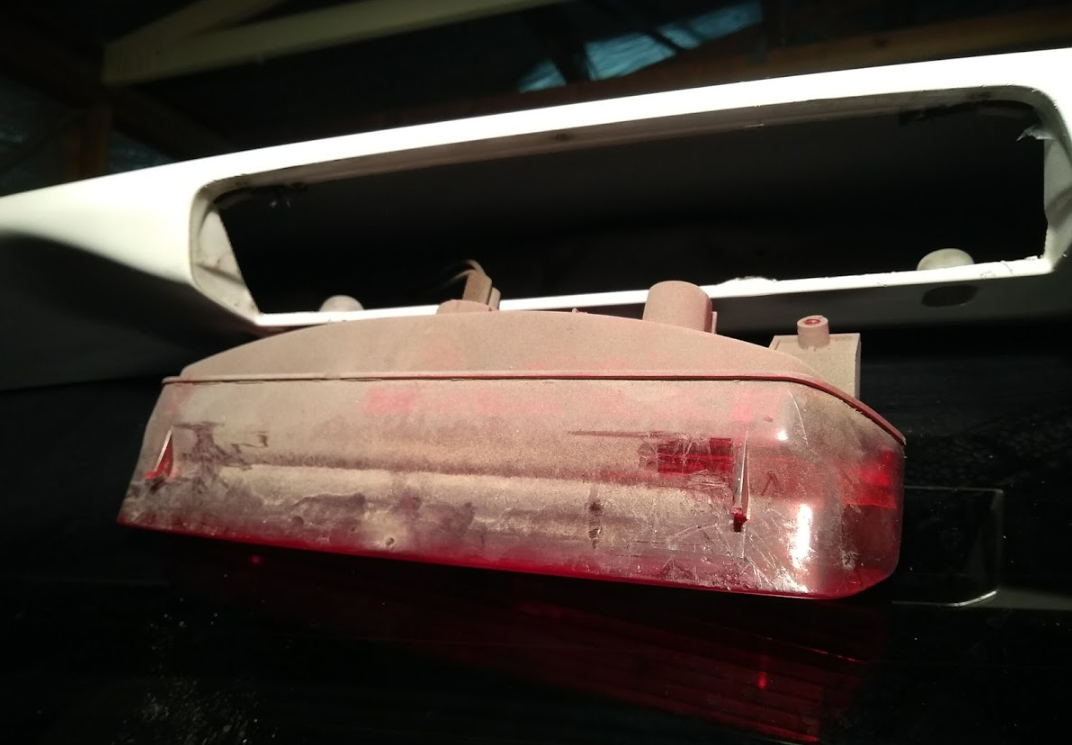

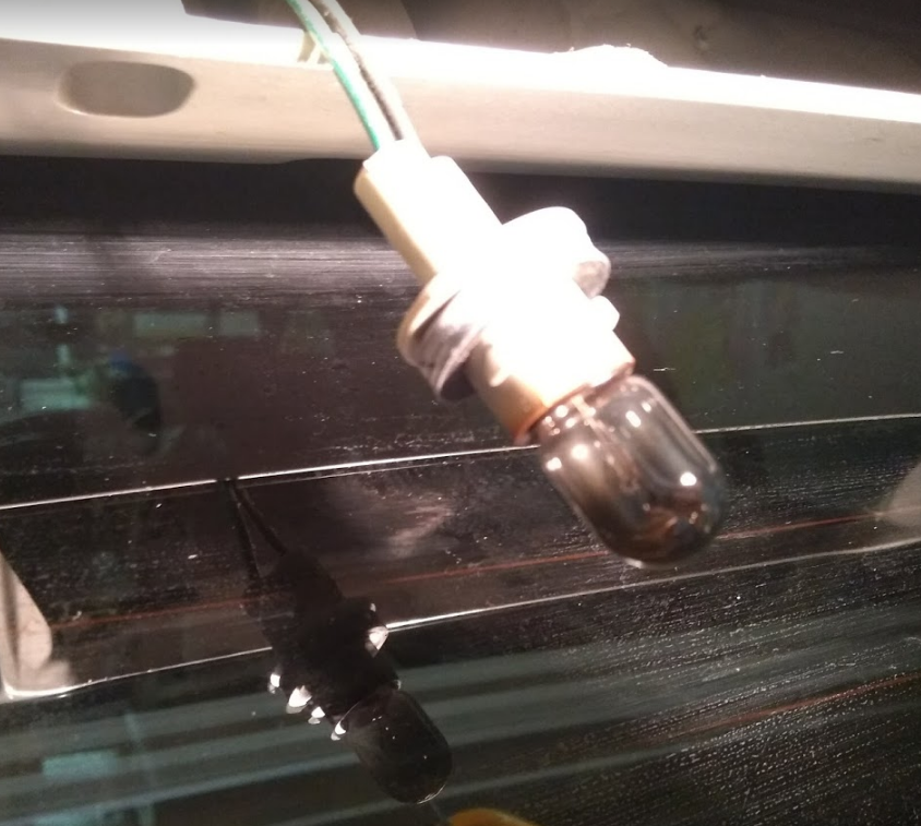

Thanks for the info Guys. Only thing that I can add are these photos which would have made my life easier if I'd seen them before spending over 45 mins trying to carefully take out the damn light! Cheers
image.thumb.png.2f110061a4ee10cb57ba2a0563688225.pngThanks Guys,
  • 1 year later...
Picture does worth 1000 words. thanks for the pic.
